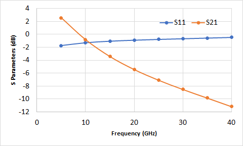

Since my strucutre is a little bit complex so It would be better for me to calculate the S21 with some well developed comercial software, and I noticed that COMSOL has been used to do lots of S parameters' calcualtions, and I also researched that the multielement uniform ports type is the most suitable one for my strucutre. However, I always get positive S21 (The S21 is a positive value at low frequency and gradually decreases to be negative), I have attached a results plot.

The strucutre I am simulating is a simple two ports coplannar waveguide (quite similar as the example "Coplanar Waveguide Bandpass Filter" see https://www.comsol.com/model/coplanar-waveguide-bandpass-filter-12099). RF Wave is only excited in port #1. As you can see my S21 (in dB) data it is positive at samll drive frequencies. Do you know what could be the reason?
S21 (in dB) should always be negative according to its definition.

If you are using lumped ports then the page you linked is not relevant. With lumped ports Comsol will calculate S parameters from the port voltages and currents.
I suggest either (1) simulating a length of uniform transmission line, to be sure you get the expected results (S11 = small, S21 =1) and/or (2) posting your model.
