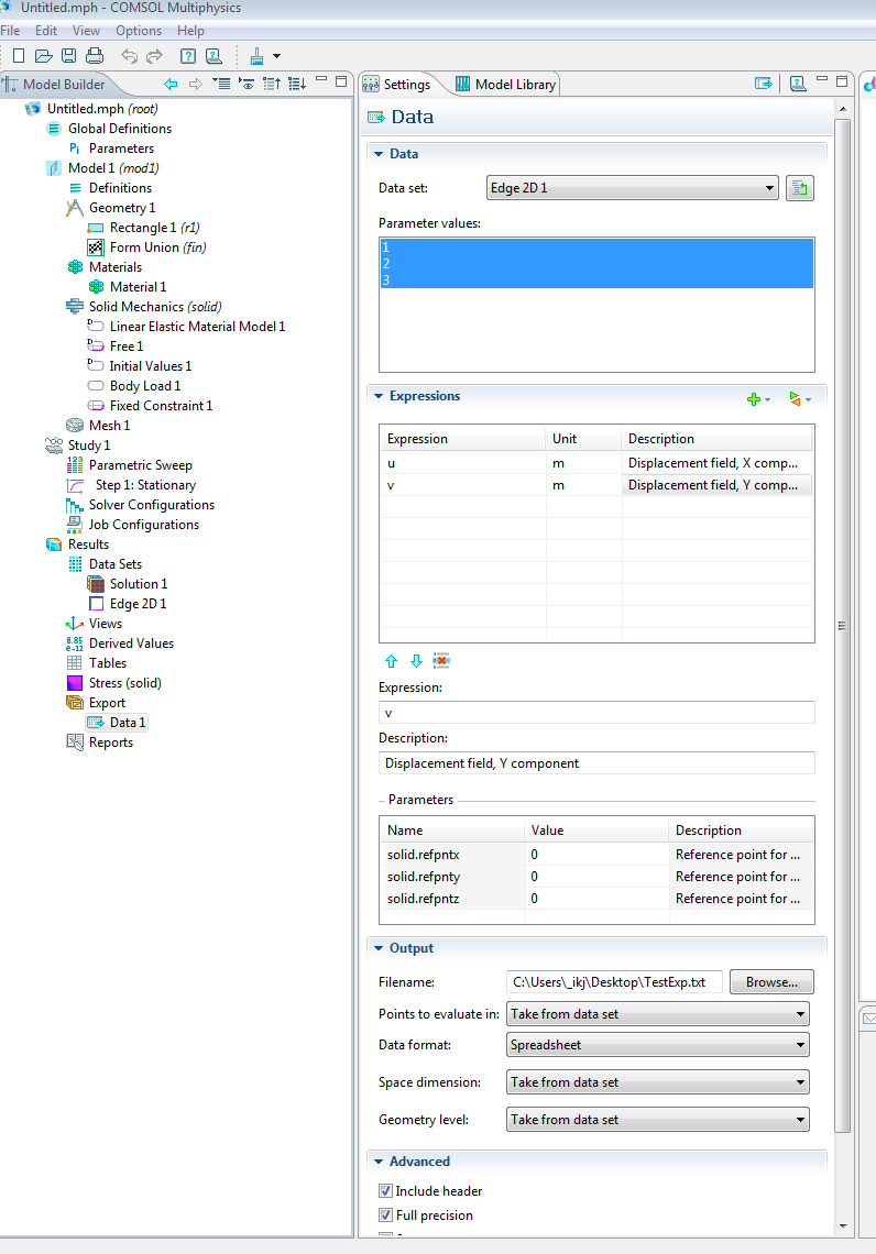

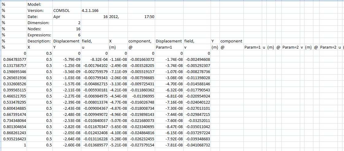

try the following:
Data Set edge or surface or cut line, plane ...
Right Click export
Define the variable(s), the interpolation, the format, file name ...
Export F5
Hi try the following: Data Set edge or surface or cut line, plane ... Right Click export Define the variable(s), the interpolation, the format, file name ... Export F5 -- Good luck Ivar
