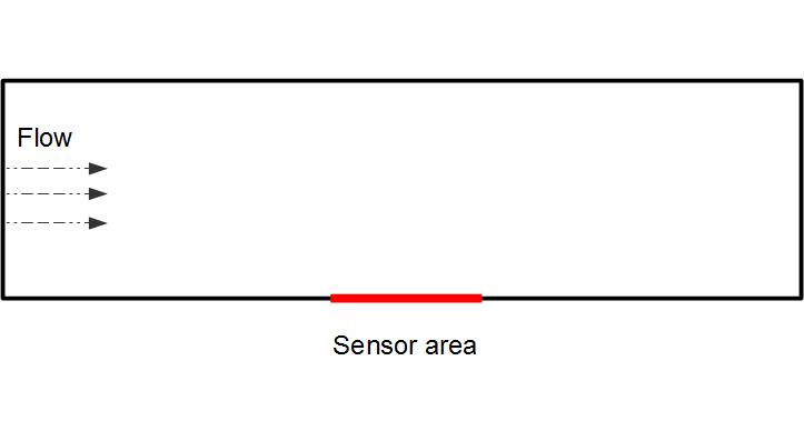

I am a fresher in Comsol, so I am starting with a simple model (as shown in the image below). I want to do some model with surface reaction in the diffusion model. I have couple of questions>
1. how can i define the sensor area in comsol? I can do the different with rectangle and circle, but I can not do this with line and rectangle.

one way is to define a variable as the integeation of operand "1" over the boundary, this applies also to volumes for domains etc.
Hi one way is to define a variable as the integeation of operand "1" over the boundary, this applies also to volumes for domains etc. -- Good luck Ivar
