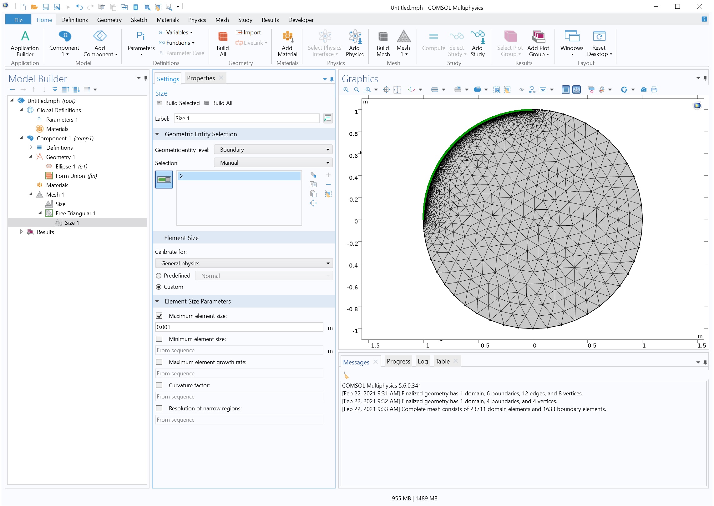

You should use a user-controlled mesh. You can choose values for maximum mesh sizes individually in domains, on surfaces, along lines, and around points. For example, the attached screen shot shows a circle where one arc has been meshed much more finely than the rest of it.
Added: Looks like Jeff Hiller got to this first. :)
You should use a user-controlled mesh. You can choose values for maximum mesh sizes individually in domains, on surfaces, along lines, and around points. For example, the attached screen shot shows a circle where one arc has been meshed much more finely than the rest of it. Added: Looks like Jeff Hiller got to this first. :)
