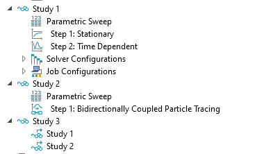

I am trying to run 2 studies in a comsol batch. In the COMSOL GUI I make a study 3 which is combining study 1 and study 2.
Study 1 : Stationary and time dependent substudies (stationary is input for TD) Study 2: Bidirectionally coupled study
Within these 2 studies I also try to do a parametric sweep (see attached image for study tree).
