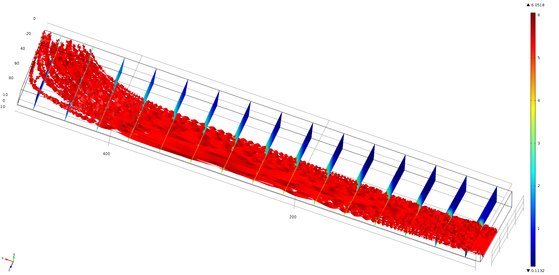

I have problem with simulation of flow of air through the elbow channel. I have the box 500x50x80mm with the fi 50mm inlet from 50x80mm side and whole base (500x50) is an outlet with grill which should ensure flow only in normal direction (see attached model).
The task I am facing is to obtain the pressure distribution at the outlet.
I think my problem is connected with proper meshing of the problem and setting the boundary conditions, but still I cannot obtain any solution.
The usual errors I get are that the limit of Newtonian iterations have been reached.
Could you help me with making this model to run?

Nevertheless, when I utilize your model, whatever pressure I set at outlet, the flow profile doesn't change (it seems to only bias the whole solution).
Another problem I found is that in this model : there is always a "backflow" into the chamber next to the inlet, while measurements show no such a behaviour. I have an outlet flow velocity profile measured:

As I mentioned above, I decided to use "Boundary stress" with "normal stress, normal flow" condition and :outlet: boundary type.
Now I am pretty sure, that my boundary resembles an array of fi 1x10mm holes. Nevertheless I still get solution which is way different from measurement data, as I described above.
Do you have any suggestions how could I get them more close to each other?

Fortunately I dig into options and I tried to apply :Boundary stress: with "normal stress, normal flow" condition.
I have slowly increased f_0 parameter for normal stress in order to obtain pressure at the inlet, which I have measured in experimental set-up.
My solutions converge well, but unfortunately I get totally different flow profile, then I get from experiment. Model output is almost a step function with rather steady "high flow" region, while experiments show almost linear profile.
do you think that adjusting turbulence parameters can lead me to solution closer to the experimental results?

All right, now I think I can see some flaws in the reasoning. You built a model with a single outlet, if you have several small holes as outlet you may not design a single one and then pretend it to have normal flow only.
It is important to note that normal outflow is a consequence of the design of the domain; therefore it will be extremely difficult that you will manage to force a normal outflow if the design of the domain does not support it.
CFD is intertwined with geometry and even small changes in it may determine large differences between real results and computed ones.
You may re-design the domain to match the actual geometry of your device. Please note that you just said that "The output in the real model consists of number of fi 1mm holes in 10mm thick block", however you have designed a single rectangular outlet.
