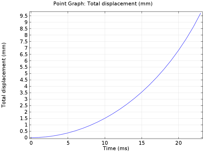

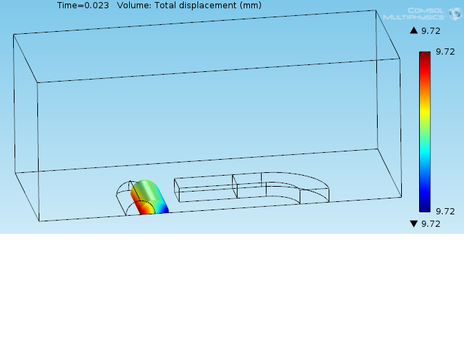

There are multiple issues in your “permanent_magnet.mph” setup.
Some (not all) issues are listed below.
Solid Mechanics:
- Air domain should not be included
- Body load should be applied to the solid part which is moving (not to all domains)
- Replace Fixed Constraint by appropriate constraints along symmetry planes
- Prescribed Displacement node is not needed since movement of the solid body is governed by Body Load
Moving Mesh:
- Free Deformation should include only domain where is deformed, i.e. air domain
- Symmetry constraints are needed for two symmetry planes. These constraints are imposed by Prescribed Mesh Displacement Nodes
-There is no coupling between Mowing Mesh and Solid Mechanics nodes
Attached is working mph file of your model for the case when magnet is fixed and rod is moving. This is not an attempt to solve your specific problem but to show general setup steps for Magnetic/Solid/Moving Mesh coupling.
Note, that you can replace Solid Mechanics node by ODE and DAE Interface if you are not interested in deformation of moving solid – see example “Magnet Falling through Copper Tube” from Comsol Model Library.
Sergei

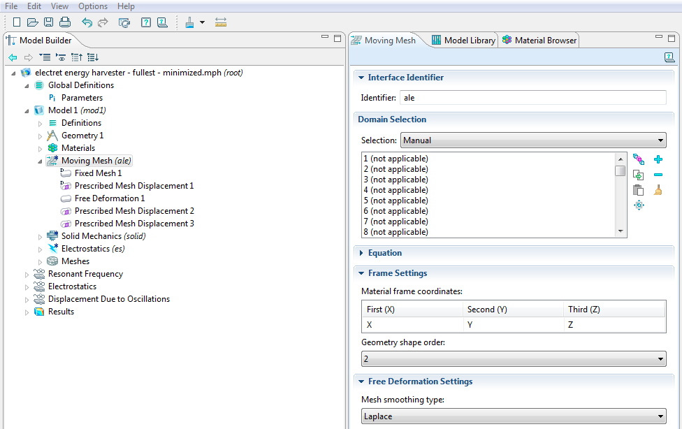

When I set my moving mesh ALE node before the solid mechanics node, all the domains I had chosen in the moving mesh become not applicable. Please see attached screenshot.
Thanks,
that is exactly it, Solid has its own frame system so this overides ALE, ALE is for air (which is no solid) domain that is deformed by the solid deformation (check the model library examples)

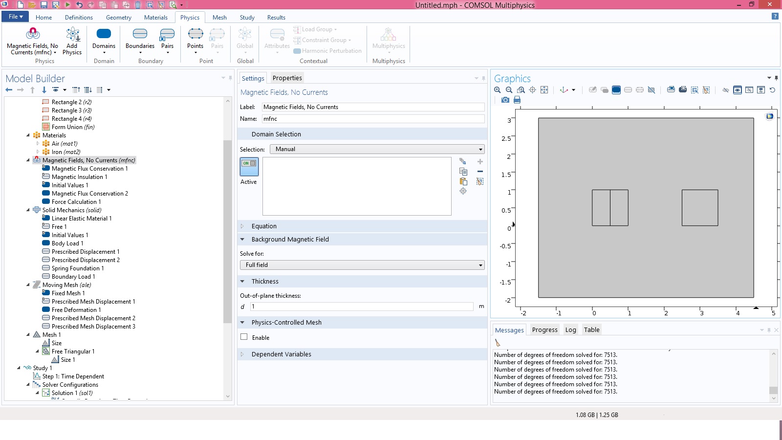

I have attached a model. In this model I have two magnets which can be the same polarity or opposite.
The magnets are in tip of the rods, and I want to see the rods deform when the magnets have same or opposite polarities.
I have defined Magnetic and Solid Mechanics physics, but I want comsol to calculate the magnetic force and put it as boundary load in solid mechanics.
Because if I put the magnetic estimated load (magnetic module estimate) as body load in solid mechanics, then the force direction is decided by me, and not by Comsol.
So this is not actually coupling, I am getting the force by magnetic module estimation and putting it as boundary loan in solid mechanics and deciding in which direction it should be!!
I would appreciate your help in this matter.
Thank you
I have been trying to do the same with 2D model witth square shapes. I implemented the familiar steps but result is failure. Can you help me to solve this?
Sincerely.
