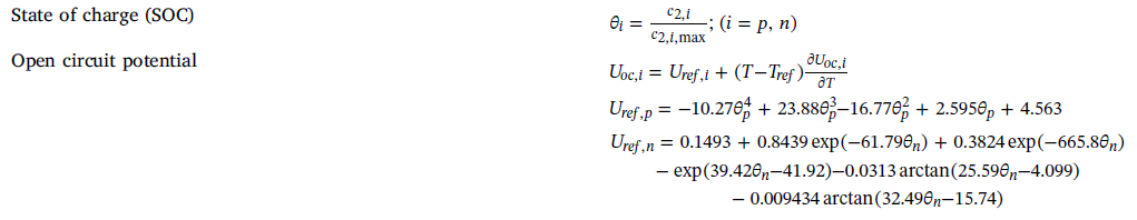

I am working in the lithium-ion battery and want to add some expression in the COMSOl. How can we rite these below attached expression.
