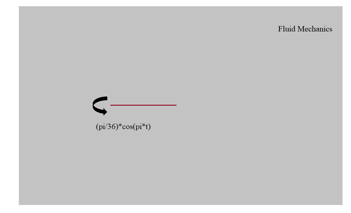

                                                    Hello Sahrish,
If the plate is rigid and you only care about how its oscillations induce flow, you can use the Deformed Mesh Interface. The angular rotation in your case looks like it's going to be relatively small, but this blog post should still be useful to you. This one is closely related to your interest, and a fun read too. You will probably also enjoy this other blog post on modeling fish swimming, especially if you may at some point be interested in looking at the stresses inside the plate.

Dear Jeff
Thank you so much for your response. Let me check the blog post, i hope I will come up with something. Will get back to you.
Sahrish
