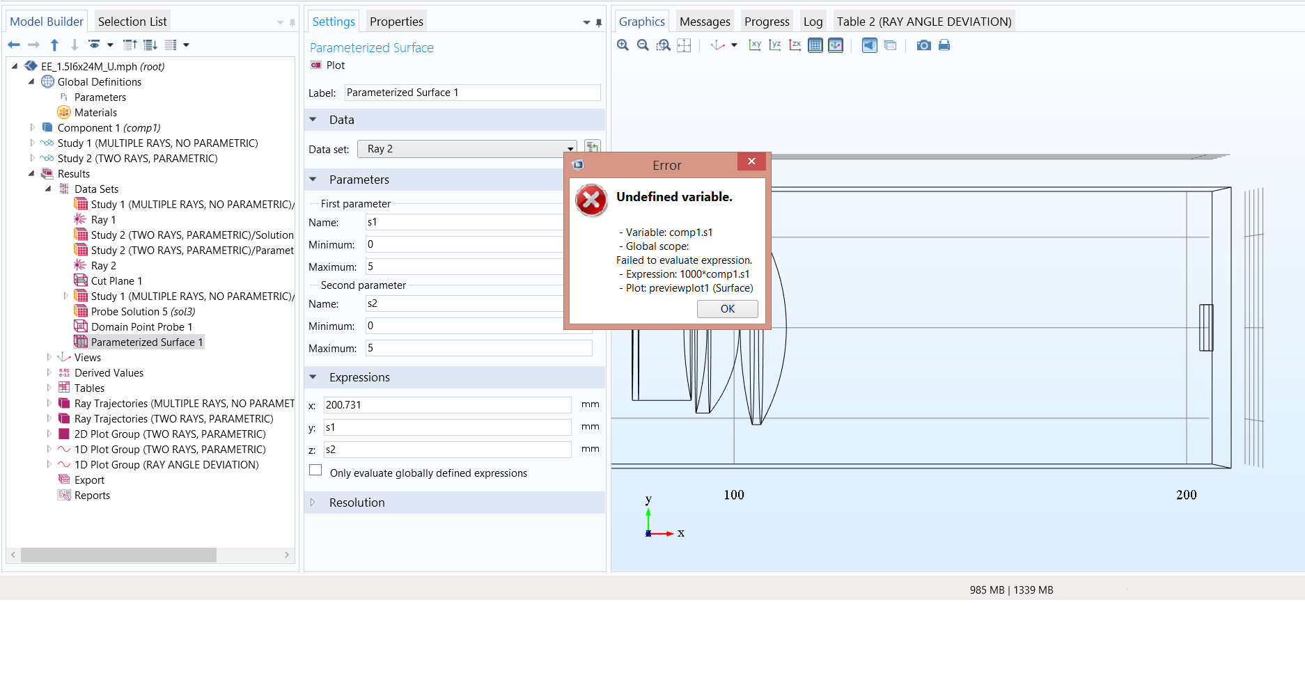

Posted: 10 years ago 10 déc. 2015, 15:50 UTC−5
I forgot to add in last post; as you have asked for a rectangular yz plane; just vary s1 from y1 to y2 and s2 from z1 to z2
expressions > x = x1; y = s1; z = s2 ... that you give you a small rectangular cut plane.
Good luck.
Dear Mranal,
I tried plotting Parameterized Surface as you suggested, but I have got a error (see the attachment). Could you please point out a mistake?
[QUOTE] I forgot to add in last post; as you have asked for a rectangular yz plane; just vary s1 from y1 to y2 and s2 from z1 to z2 expressions > x = x1; y = s1; z = s2 ... that you give you a small rectangular cut plane. Good luck. [/QUOTE] Dear Mranal, I tried plotting Parameterized Surface as you suggested, but I have got a error (see the attachment). Could you please point out a mistake?
