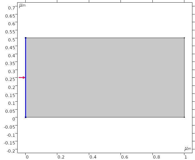

as a minimalistic example, suppose I have the longitudinal section of a waveguide represented as a rectangle. The left side border (in blue) is the input port, exciting a fundamental TE mode and the right side border is the output mode as shown in the following image:
https://i.postimg.cc/Hkw0hS80/waveguide.png
After making the Boundary Mode Analysis of each mode, I'm able to propagate and obtain this result, https://i.postimg.cc/kg5yHN9B/waveguide2.png
Now my problem is that I want to make an overlap integral between the modes of both ports (1 and 2). I have followed these steps without success:
