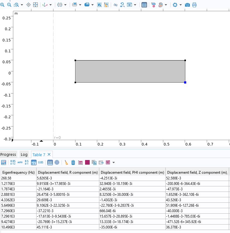

From the study I get complex-valued mode shapes and natural frequencies for m>0. The natural frequencies have a negligible imaginary part and the mode shapes (i.e. the displacement field components u,v,w) are either purely real or imaginary or some complex number, see Screenshot1. I am only aware of complex modes for non-proportionally damped or rotating mechanical systems. Maybe I miss something here, I would have not expected them in this type of study. From what I know about the theory, using a Fourier series of cos(m.theta) and sin(m.theta) for the variation around the circumference (or theta direction) yields real-valued mass/stiffness matrices and modes (apart from rigid body motion with perhaps imaginary natural frequencies).

many thanks for your quick response. Your answers make sense, thanks for explaining. When looking at the sequence of real and imaginary numbers of the three phasors u,v,w (displacements in r-,-,z-direction respectively), see Screenshot1 in the original post, it is in good alignment with the theory/equations I was aware of. If written as Fourier series, the equations I mean (taken from M. Petyt, Introduction to Finite Element Vibration Analysis 2nd edition Chapter 5) are of the format:

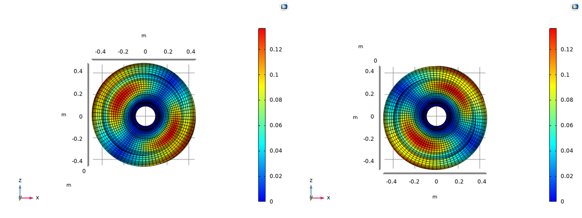

When solving a full 3D model, each mode for m>0 has multiplicty 2; one with the symmetric and antisymmetric variation in , see Screenshot2. I assume, I just need to swap the relationship you posted Henrik (based on what can also be seen in the second part of the sum within the equations I posted). Is that correct? Just to be sure, I bring everything into the right context.
Sometimes a tiny real or imaginary part is present (many orders of magnitude smaller). I assume, it is just a spurious numerical effect and can be ignored. But for some modes, the phasors have a real and imaginary part of about same order of magnitude (see mode 2,4,6,8,9 in Screenshot1 above). This is no longer in alignment with the equations, when having sin or cos distribution in theta with an additional initial phase (if I see this right). Do I have to treat them differently to return a purely real-valued number? Can I even return it in that case without deleting the overall phase relationship between the DOFs for such a mode? I hope this makes sense.

Modes can be computed with an arbitrary offset in the circumferential direction. Thus, you may see complex numbers, rather than purely real and imaginary. If you look at the phase angle, using for example arg(u) and arg(v), you will see that the difference is still 90 degrees. If you look at the same mode in the 3D representation, you will find that it is not aligned with the x- and y-axes.
As you mention, some modes are duplicated in a true 3D setting. You do, however, only get one eigenfrequency / mode pair in the axisymmetric model.
