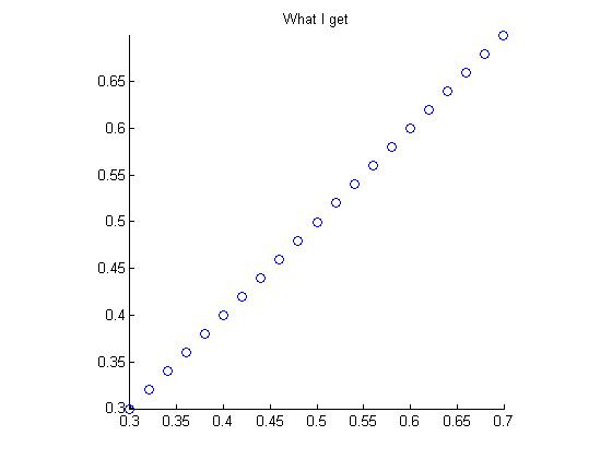

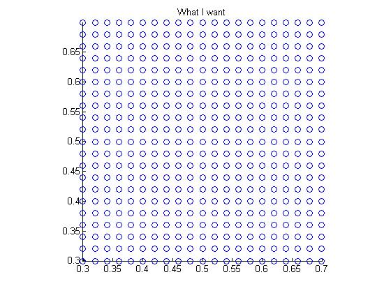

Hello Aditya K
                                                Posted:
                                1 decade ago
                                31 oct. 2012, 19:41 UTC−4
                                                    Hi Aditya,
Did you ever get an answer?  I have the same problem.
--Josh
                            Hi Aditya,
--Josh

                                                    Thanks Daniel and Aditya for your replies.  I am also using the basic particle tracking functionality in Multiphysics, although if I continue using it regularly I will definitely consider purchasing the new particle tracking module.
Aditya, my version of Matlab is so old, I'm not sure your solution will work for me.  I did find one other workaround.  I realized that it is possible to enter a long sequence of coordinates without using the range command.  For example:
x:  1, 2, 3, 1, 2, 3, 1, 2, 3
y:  1, 1, 1, 2, 2, 2, 3, 3, 3
So if you want a grid that is 3 rows and 10 points in each row, you have to enter 30 numbers in both the x and y input boxes.  This is a real pain, especially if you need to calculate odd spacing.  But it is possible to generate the correct sequence in Excel (where you can use equations to create the proper spacing as needed), and then export to a CSV.   Then you can open the CVS in a text editor, copy the number sequence and paste into the Comsol GUI.  Still kind of a pain but it did work for me.  I think it would also be possible to create a serpentine polygon in the domain that you can define as a selectable boundary.  Then you can define points evenly spaced along this polygon using boundary coordinates.  I didn't try this yet because the CSV trick ended up working for me.
