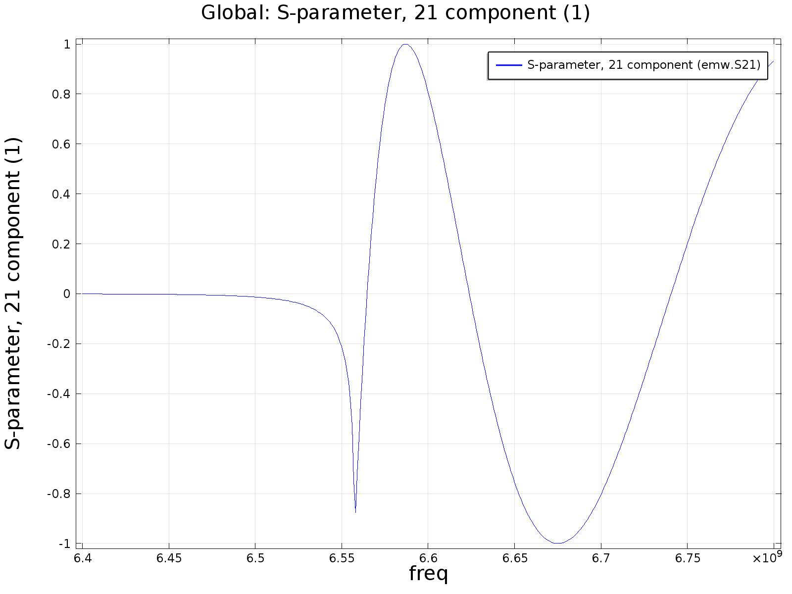

-S21 has peaks. Evident when exporting data and analyze it presents oscillation between 1 and -1

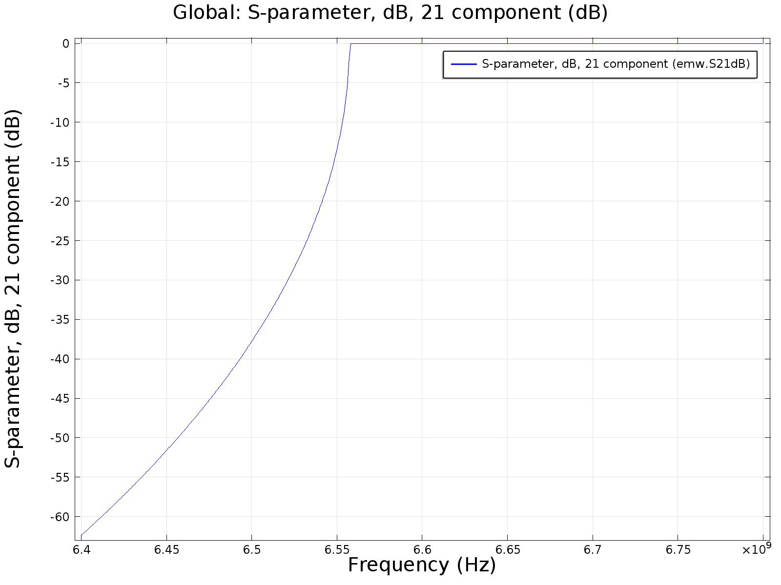

-dBS21 plot in COMSOL, the oscillatory beahavoir of S21 is not presente and what is more strange is when calculated

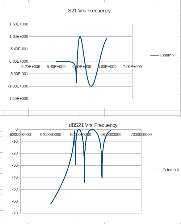

with the formula (dBS21 = 20 * log (abs (S21)), I get different values from those used in the graphic COMSOL dBS21 and the oscillatory beahavoir is present.
If Comsol used otherwise for caculation of dBS21 parameter please enlighten me, that the results did not close.

have you run and studied the Model library "Branch Line Coupler" ? you might find some replies thereby. It is indeed strange that the dB and linear representastion are different, I suspect you have something else you are missing
I have been analyzing the data, exporting data comsol and plotting in other software. When applied to the above equation at S21 data get the same results, but after some resuts the Comsol data tend to zero while the result obtained with the equation oscillated respect to zero but the magnitude is very diferent.

how do you normalise the S21 curve to get the dBS21 curve?
As you have S21 positive and negative, you canot take the log of that without some renormalisation.
Your dB curve sem to pass by "0" at each extrema of S21

You can explain how I can view the equation, because I have no idea. I used absolute value of S21 for applied the logaritmic funtion as mentioned in the RFModuleUsersGuide for S11.

OK if you take the absolute value of an oscillating (alternating sign) function you double the peaks, and that explains the alternances of zeros and extremas
