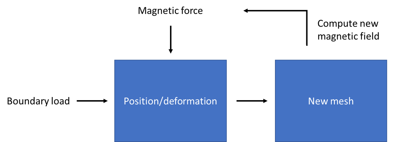

I am trying to simulate a resonator which is subject to both applied external force and a magnetic force in 3D. The applied external force is defined, while the magnetic force needs to be computed, using Maxwell stress tensor, at each position of the resonator in space. I want to compute the device displacement using a time dependend study. At each time step I would like to compute the displacement of the resonator due to both external and magnetic force and update the magnetic force for the following step given the new position of the resonator.
I have tried to use a time-dependent study with both solid mechanics and magnetic field no currents. They both converge if only one physics is used, but they fail to converge when used together. I imagine that I should use moving mesh at each step to update the position of the resonator in space and compute the new magnetic field and maxwell stress tensor. The problem is that solid mechanics says that it cannot be used on deforming domains.
