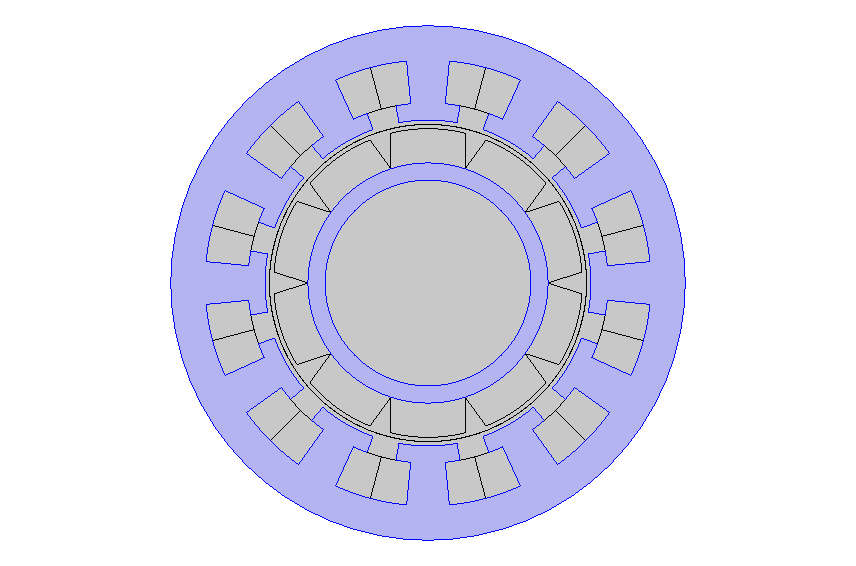

Hi all,
I have an electric motor made in 2D space dimension and wanted to find the torque for different material used on the stator. I have tried to use different types of silicon steel (the ones which are on the COMSOL library) and soft iron (without losses). I have attached a picture of the motor design with the highlighted domain to be where the materials are applied to.

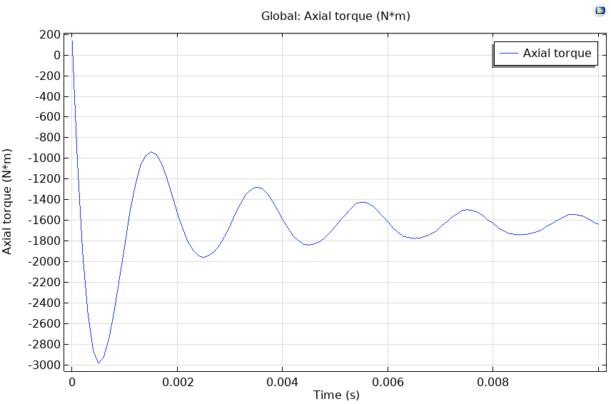

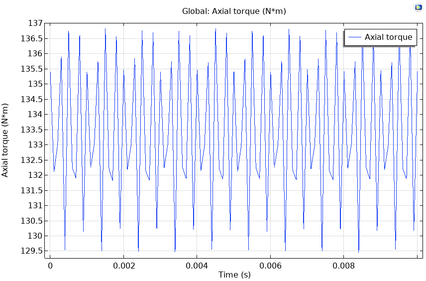

Only when I use soft iron (without losses) that I get an actual torque output compared to any other materials I used. I have attached the graph for each material. I ran a parametric sweep for the current input in the coils and for the soft iron, I managed to get a varying torque to current graph whereas for any other material, the torque remains the same as when I apply 0 A or 10000 A.
Can anyone explain to me the reason for this problem please?
