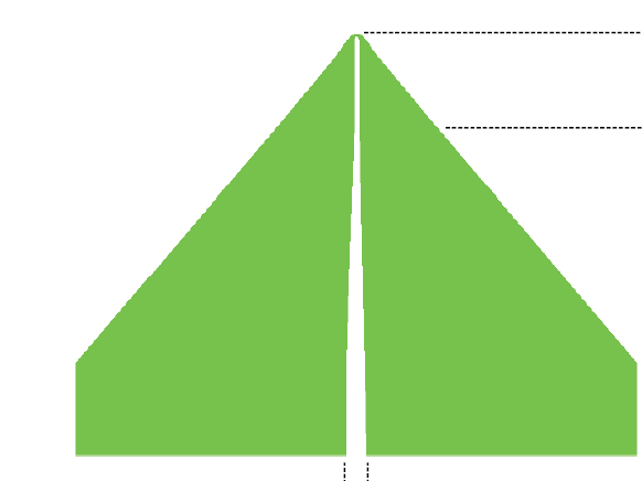

with my device above I get a good result. Now I want to check if comsol calculate the standing wave correctly.
So I've created a simple device (coplanar strip)  where to ac currents converge, so that there should arise a standing wave.
I created the ac currents  like described above. But I get no meaningful result. I should see the standing wave in the E-field, but the E-field is only at the ends. So I need again your help :).
 I attached the file in this link:
daten-transport.de/?id=a9Z3dwPNLrb8
The normal upload does not work right now.
Thanks in advance
Thorsten

first of all at 1.5 GHz I'm not sure you can use correctly ACDC for 1 meter long structures, your wavelength in vacuum is only 0.2 m
then if you impose a current of +1 on one side and -1 on the other side I do not understand the flow, are you sure you ddi not mix up your GND and Terminal 1 and 2 ?
Finallyyour mesh is a too coarse for a 20 cm wavelength, you must sample correctly your fields

First of all, I deleted my mesh completly :) . Normally it is very fine. But I have the feeling that the AC current is not correct. If I only apply one current and replace one terminal by a GND, I get no flow.
And I tried  with many different frequencies, so that can't be the mistake.
And I don't mixed up the terminals and GND. If I switch a terminal with a GND I would not get a standing wave?!
Regards Thorsten
                            Again thanks Ivar
Regards Thorsten

but what I see is one stripe with GND on both ends and one stripe with current flowing out at each end, where does it enter ?
But I might have missed something, quickly done ...
                                                Posted:
                                1 decade ago
                                7 juin 2012, 07:33 UTC−4
                                                    okay, the currents should flow in and form a standing wave. It is the same idea as above in my stripline. I just wanna check if comsol does calculate my strilpine correct. But there is no standing wave in this model so I think there is no standing wave in my stripline as well. I made an even simpler model. There is only one AC current and one GND, but the result is in my eyes nonsense. So I believe my current is wrong.
Do you believe that I applied the currents correct?
Sorry that I ask so much, but I am really desperate right now :)

first, for me your mesh is too coarse, you are hardly at the Nyquist criteria for air, minimum "Finer" if not "Extremely fine"
second, MEF and ACDC is for models that are "small" compared to your EM wavelength, but in your case your model is 5x larger than a wavelength in air. This is more for the RF module hypothesis that solves the Maxwell equation in  more complete form (wavelengths are "short w.r.t. model size").
Now, it's true your are still somewhat in the middle "grey" zone, where neither or both might be still more or less OK to solve your issue
