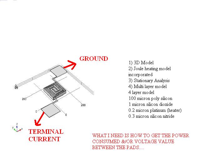

I'm currently working on a device called micro-heater and I'm using COMSOL 4.2 for the purpose of my simulations.
I have used the Joule Heating model and have applied Terminal Current as the source of electric current to the device.
I'm getting the results for the temperature achieved but I'm also interested to get either the power consumed by the device or the voltage across the terminals of my device or both if possible.
Please suggest a suitable option for the same.

Respected Sir
Thank you for your reply
As you had instructed I went to the Results --> Derived Values--> Global Evaluation--> Add Expression ("+"sign in green color) --> Added terminal voltage from Joule Heating(Electric Currents)
I then evaluated it
Got the error
Failed to evaluate variable.
-Variable: mod1.V
-Global Scope:
-Expression: real(mod1.V)
Please tell me what could be the problem.
Respected Sir Thank you for your reply As you had instructed I went to the Results --> Derived Values--> Global Evaluation--> Add Expression ("+"sign in green color) --> Added terminal voltage from Joule Heating(Electric Currents) I then evaluated it Got the error Failed to evaluate variable. -Variable: mod1.V -Global Scope: Failed to evaluate expression. -Expression: real(mod1.V) Failed to evaluate expression. -Expression: real(mod1.V) Please tell me what could be the problem.
