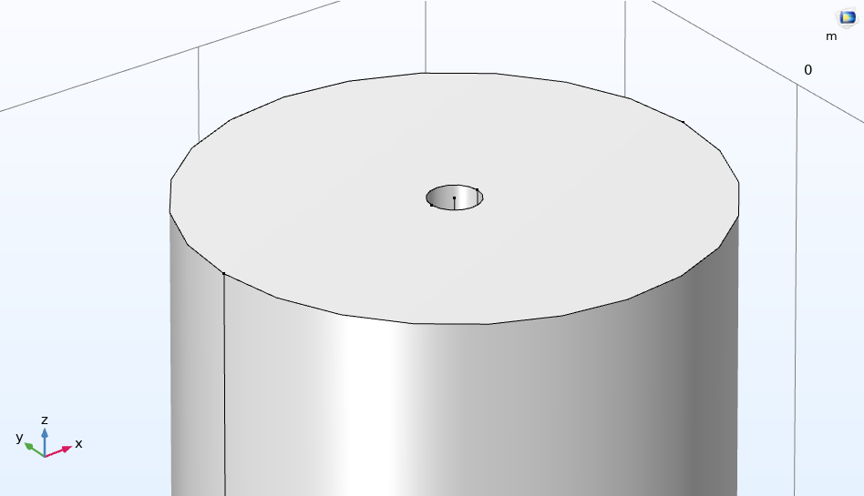

I am attempting to use the Heat Transfer in Pipes interface to simplify a model which couples flow through a pipe with the heat transfer in a solid domain surrounding it. However, as the 1D model represents the 3D pipe with a single line segment (zero radius), this leaves space between the boundary of the solid domain and the edge of the line segment. I have included a simple picture to illustrate what the geometry would look like.
Is there a way to couple the Wall Heat Transfer node with a Solid Domain that is not in contact with the line segment, as well as one of the Thin Structure Boundary conditions for the Solid Domain with the 1D line segment?
