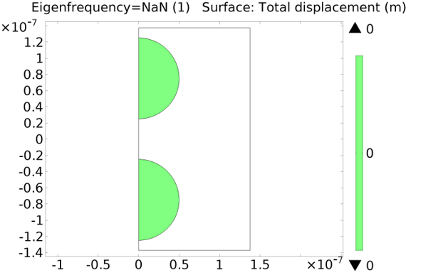

When I did it, the Eigenfrequencies return as NaN. Please see attached.
Hi Edgar, When I did it, the Eigenfrequencies return as NaN. Please see attached.
Posted: 4 years ago 18 juin 2021, 11:58 UTC+2
Well, I tried it and it solved. Those pictures do not help.
