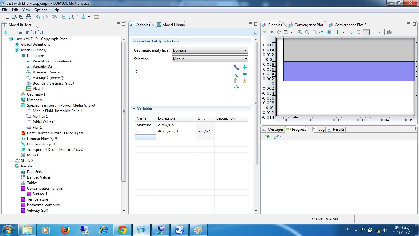

Posted: 1 decade ago 9 déc. 2013, 05:34 UTC−5
if(c<0,eps,if(c>1,1,c))
Dear Tero,
First i would like to say thank you because ,i am doing my MS project "modeling of electrosorption" using comsol version 4.3 at Hindustan Unilever R&D,Bangalore and i got the same problem of getting negative values or larger values which are not expected.I searched for resolving this problem in various literatures and available comsol materials but i did not find anywhere and finally i found randomly here(discussion forum) and i tried it and its working well.But i have a few doubts about defining this condition.
(1)How much small number is this eps? or is it constant small number?
(2)what is the condition if c lies between 0 and 1 i.e (0=<c=<1) (here =< represents less than or equall)?
could you please give me the combined condition for this(for all three conditions).

Here is one trick to solve negative concentrations.
I made variable "C" which is defined by "if(c<0,eps,c)" under Definitions => Variables. Instead of concentration "c" I used variable "C". Now variable "C" is never below zero. Eps is very small number defined is Comsol.
Does this help you?

Hi Tero
I try this for species transport in porous media but my finally concentrations are negative. my problem is unsteady.
Best regards
[QUOTE] Hi, Here is one trick to solve negative concentrations. I made variable "C" which is defined by "if(c

Posted: 1 decade ago 20 juin 2015, 07:46 UTC−4
Does this help you?
Best regard
Tero
What do you mean by - [Instead of concentration "c" I used variable "C"]?
Did you replace "c" with "C"? But c is the main variable.
Can you please elaborate?
I'm sorry, my doubt might be trivial since I'm new to COMSOL.
Thank You,
Shiva

Posted: 8 years ago 2 mai 2017, 06:47 UTC−4
I know it is in response to your very old post. But I also have the same negative concentration. And I am not able to incorporate the trick you suggested in this post. How do you have 2 variables for concentration c and C?
Hi, I know it is in response to your very old post. But I also have the same negative concentration. And I am not able to incorporate the trick you suggested in this post. How do you have 2 variables for concentration c and C?
Posted: 8 years ago 5 mai 2017, 02:56 UTC−4
I haven't use Comsol for ages but I try to remember how this was done.
Yes, I have two variables where "c" is Comsol own parameter and "C" is new variable for calcuation purposes. "C" is used in reactions to prevent negative concentration and it is never below 0.
Did this answer to your quoestion?
Best regards
Tero
Hi, I haven't use Comsol for ages but I try to remember how this was done. Yes, I have two variables where "c" is Comsol own parameter and "C" is new variable for calcuation purposes. "C" is used in reactions to prevent negative concentration and it is never below 0. Did this answer to your quoestion? Best regards Tero
