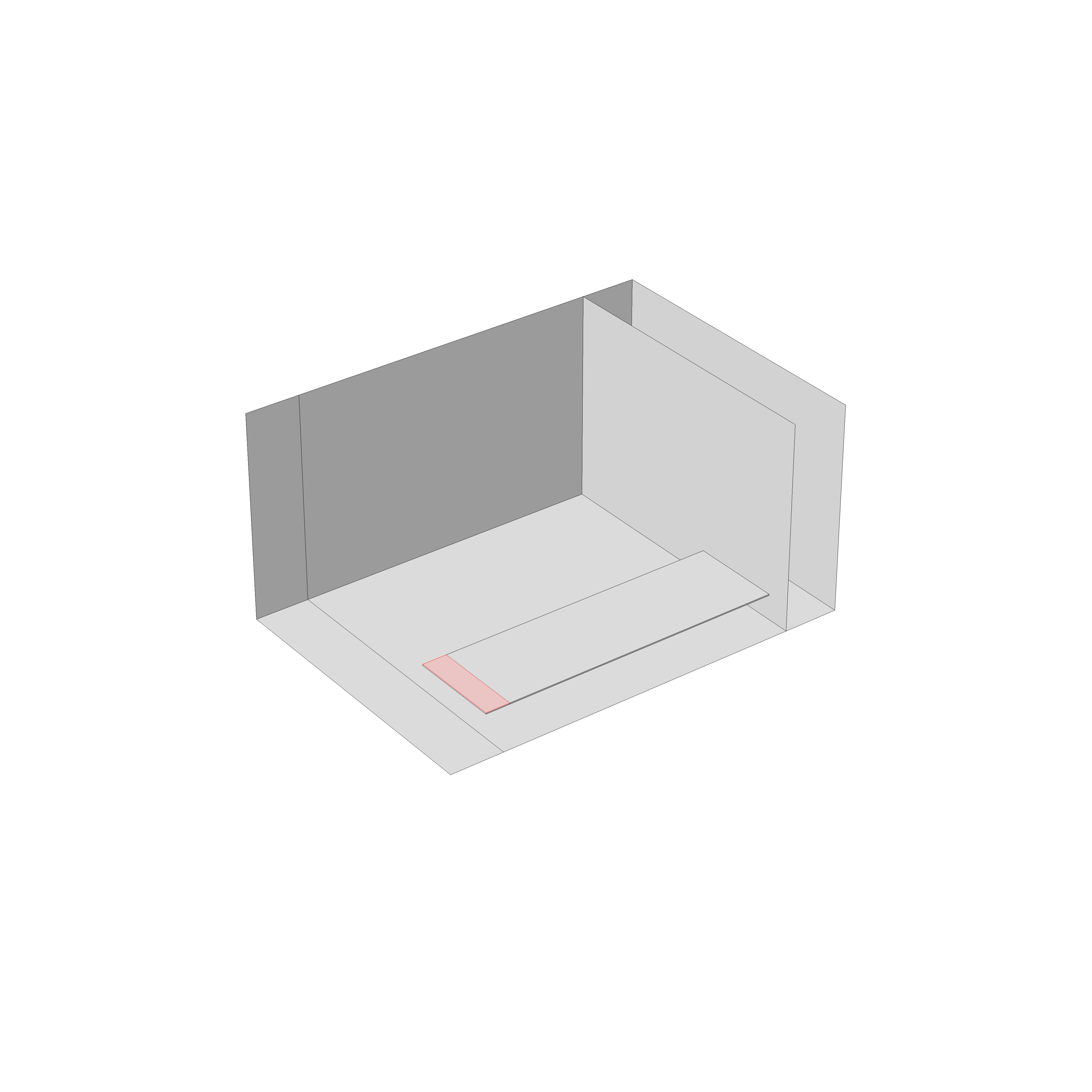

I'm trying to adept this example to a 3D problem. I have drawn a simple beam in 3D and I have the stationary simulation working fine. I apply a potential and compute the deflection. It takes 28 seconds, it's a small mesh.
To derive an estimate for the pull-in potentional I add a global equation solving (intop1(z)-zset)/zset
I pick the centre point of the beam for intop1.
In the stationary study I add the continuation parameter zset with range(1600[nm],400[nm],2400[nm])
I change the solver to fully coupled.
The simulation however does not converge, it is stuck at step 1.
Does anyone know how to solve this?

I also have the same issue in version 4.4. Im trying to find the pull-in voltage of a very simple 2D cantilever with the Global Equation method described in the "biased_resonator_2D_pull_in" example in the model library but whenever I set the desired deflection to be >0 (but still less than where pull in should occur) the simulation does not converge. I tried many different meshes to no avail. The simulation runs as expected without the global equation (does not converge only for V>Vpull_in as expected). Is this an issue with COMSOL? The model Im using is attached.
Hi, I also have the same issue in version 4.4. Im trying to find the pull-in voltage of a very simple 2D cantilever with the Global Equation method described in the "biased_resonator_2D_pull_in" example in the model library but whenever I set the desired deflection to be >0 (but still less than where pull in should occur) the simulation does not converge. I tried many different meshes to no avail. The simulation runs as expected without the global equation (does not converge only for V>Vpull_in as expected). Is this an issue with COMSOL? The model Im using is attached. Thanks

I'm trying to find the pull in voltage for this device, but I can't seem to find my mistake. I have the integration method set to find the coordinate of the center of the bottom boundary of the top diaphragm, swept mesh, and fully coupled solver with a sweep over zset. Can you take a look at this and see what can be fixed?
Hi, I'm trying to find the pull in voltage for this device, but I can't seem to find my mistake. I have the integration method set to find the coordinate of the center of the bottom boundary of the top diaphragm, swept mesh, and fully coupled solver with a sweep over zset. Can you take a look at this and see what can be fixed? Thanks
