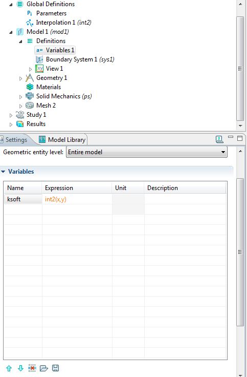

To know what the int2 is doing, I attach a screenshot.

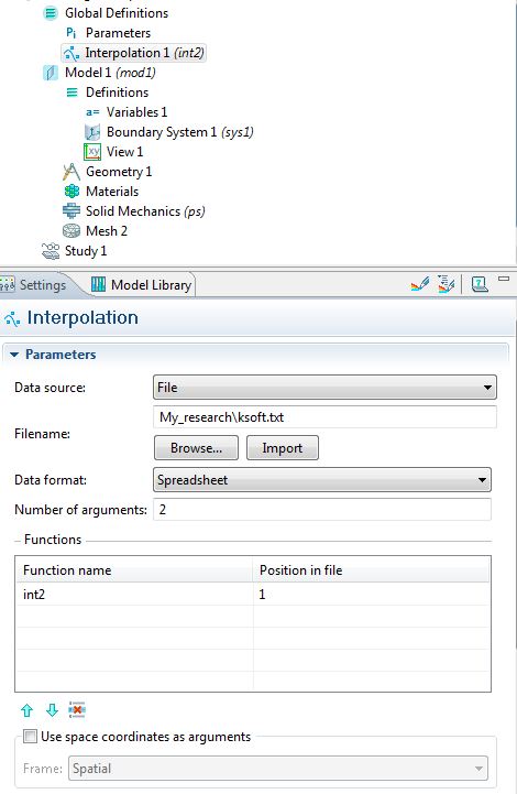

I'm not quite sure what your last 2 lines accomplish. I managed to get COMSOL to read and interpolate the .txt file by setting up int1 and the variable by hand in COMSOL, but I need to be able to set these through MATLAB (since it's going to iterate in a MATLAB loop). Any thoughts?

Suresh,
