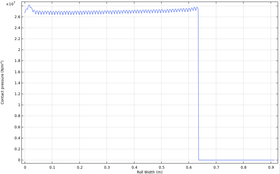

I am modeling contact behavior between cylinders and a rectangular prism. I want to see how contact pressure varies along the length of the cylinder due to uneven loading. If I create a line graph of solid.Tn along the desired edge, this has two undesired effects:
  1. Contact pressure is point pressure specifically along the edge, whereas I am interested in the total line pressure along the circumference of the cylinder
  2. Plotting this value produces artifacts, I presume (let me know if I'm wrong) from strangeness relating to meshing and sampling discrete locations (see attached). Decreasing mesh size makes these artifacts more dense, but doesn't seem to reduce their magnitude.
