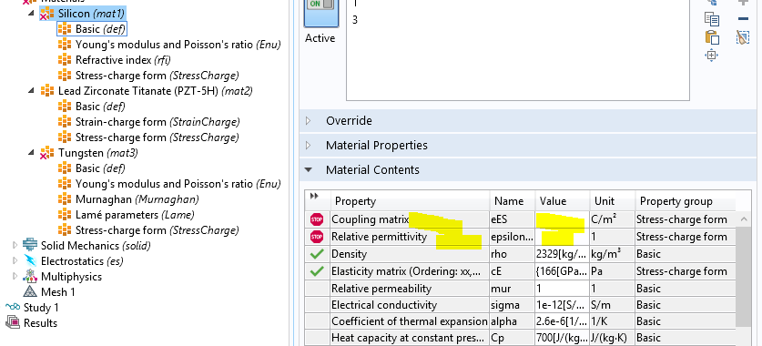

it will be highly appreciated if anyone help to solve the marks point in the attach photo, I am looking for the 1. coupling matrix, elasticity matrix, relative permitivity for silicon
2.coupling matrix, elasticity matrix, relative permitivity for tungsten.
I am using COMSOL 5 using piezoelectric device.
it will be highly appreciated if anyone help to solve the marks point in the attach photo, I am looking for the 1. coupling matrix, elasticity matrix, relative permitivity for silicon 2.coupling matrix, elasticity matrix, relative permitivity for tungsten. I am using COMSOL 5 using piezoelectric device.
Posted: 10 years ago 11 janv. 2016, 08:10 UTC−5
Silicon and tungsten are pure metals (not compound ones) and hence not piezoelectric.

Posted: 8 years ago 3 juil. 2017, 11:29 UTC−4
This issue seems to come up often. A piezoelectric material is one where the electrical and mechanical domains are coupled (through the coupling matrix!). Ordinary non-piezo materials do not have that coupling. You need to make these materials linear elastic materials.
If you look at the shear bender example you will see how these settings are done.
