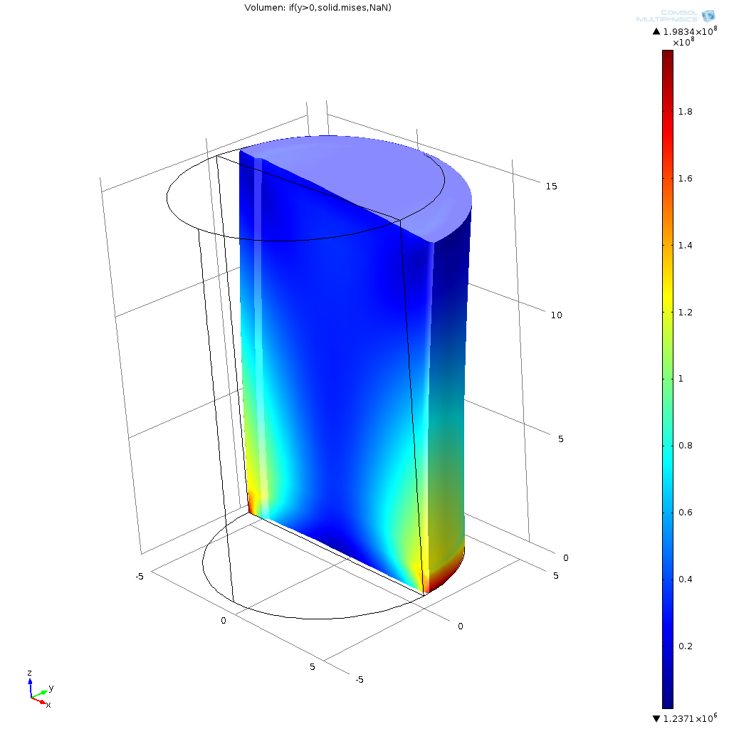

Hello everybody,
I want to evaluate some results. I have a 3D-Model in which I use symmetry. Now I would like to create a plot, where the model is cut in the middle. I want it to look like, if you you cut a cake in the middle. You can see what is inside, at the position where the knife has been, but you can also see what is on the surface of the remaining half. I did not find a hint in the help. I tried to to use a volumeplot with a filter, but then I get the problem, that I can't cut the model at any position.
