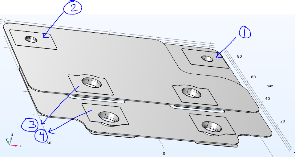

                                                    Thank you for suggestions, however, these boundaries cannot be applied inside the air domain. I have been trying to perform magentic analysis with box drawn to act as an air domain, and I was unable to connect two conductors inside the air box using the above suggested boundaries.

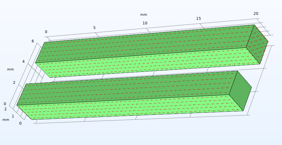

                                                    So with the Joule heatign case, it is possible to select floating potential boundaries with value of 0V which ensures continuity of current as shown below.
