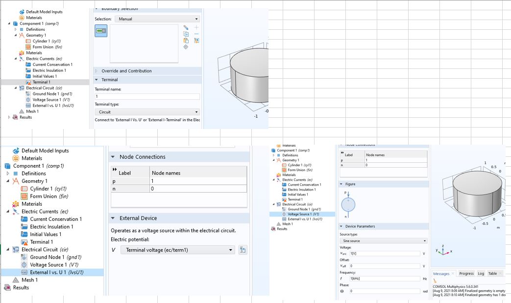

you will need to add the circuit option to the physics. i attached a screen shot of what needs to be done based on limited information. it should get you started. in ec, you add a terminal and change it to use a circuit. you then need to add a voltage source and an external coupling feature to the circuit node.
Hi, you will need to add the circuit option to the physics. i attached a screen shot of what needs to be done based on limited information. it should get you started. in ec, you add a terminal and change it to use a circuit. you then need to add a voltage source and an external coupling feature to the circuit node.

Thank you very much for your reply. However, I could not understand how to select nodes and what nodes "0", "1", "2" or "p", "n" mean.

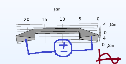

I have attached the photo of the design that I am currently working on. The comsol file can be found here: https://www.comsol.com/model/microresistor-beam-366
I want to connect positive node of the voltage source to one end and negative node to the other end of the beam, so that an AC sinusoidal current flows through the microresistor beam. (Note: There are no semiconductors, the beam is made of Aluminium)

Hello Mr. Brown, Thank you very much for your reply. However, I could not understand how to select nodes and what nodes "0", "1", "2" or "p", "n" mean. I have attached the photo of the design that I am currently working on. The comsol file can be found here: https://www.comsol.com/model/microresistor-beam-366 I want to connect positive node of the voltage source to one end and negative node to the other end of the beam, so that an AC sinusoidal current flows through the microresistor beam. (Note: There are no semiconductors, the beam is made of Aluminium) Kindly give me a direction how can I do that. Best regards, Ekram.

from your picture, it seems you want to apply a source to a floating object. i would suggest setting up the problem to ground one side to get something running. you would then have to modify the simulation to suit your needs. in any case, you will need two terminals in the physics similar to what i showed. you will also need to use two couplings.
you will need to understand what a netlist is and how to implement it. there are many tutorials on the internet that show this. probably a lot of youtube videos as well. here is one example: https://www.allaboutcircuits.com/textbook/reference/chpt-7/example-circuits-and-netlists/ from your picture, it seems you want to apply a source to a floating object. i would suggest setting up the problem to ground one side to get something running. you would then have to modify the simulation to suit your needs. in any case, you will need two terminals in the physics similar to what i showed. you will also need to use two couplings.
