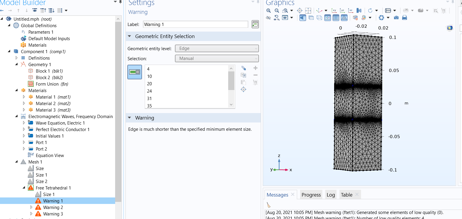

Thank you.
I watched video it was very informative but still i am not able to mesh my another geometry. I am attaching file. it has 1nm size graphene layer and 28micrometer thick silica slab. or if you suggest physics to convert volume into surface in wave optic physics.
Thank you.
