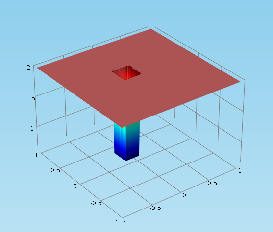

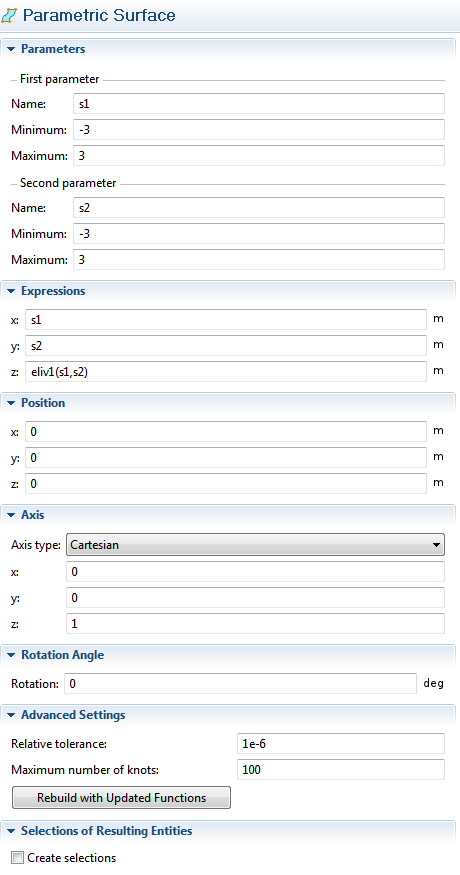

2) create a parametric surface in the geometry (I have included screen shots to illustrate).
However, I do not appear to be able to generate the surface at all. Have I done something silly?!

I think I may have solved the problem, kind of.
The issue was resolved by defining the image in Global Definitions not the Model Definitions. Once I did that the image and the Parametric Surface worked.
I am still trying to figure out exactly how to use it, but I am getting there.
