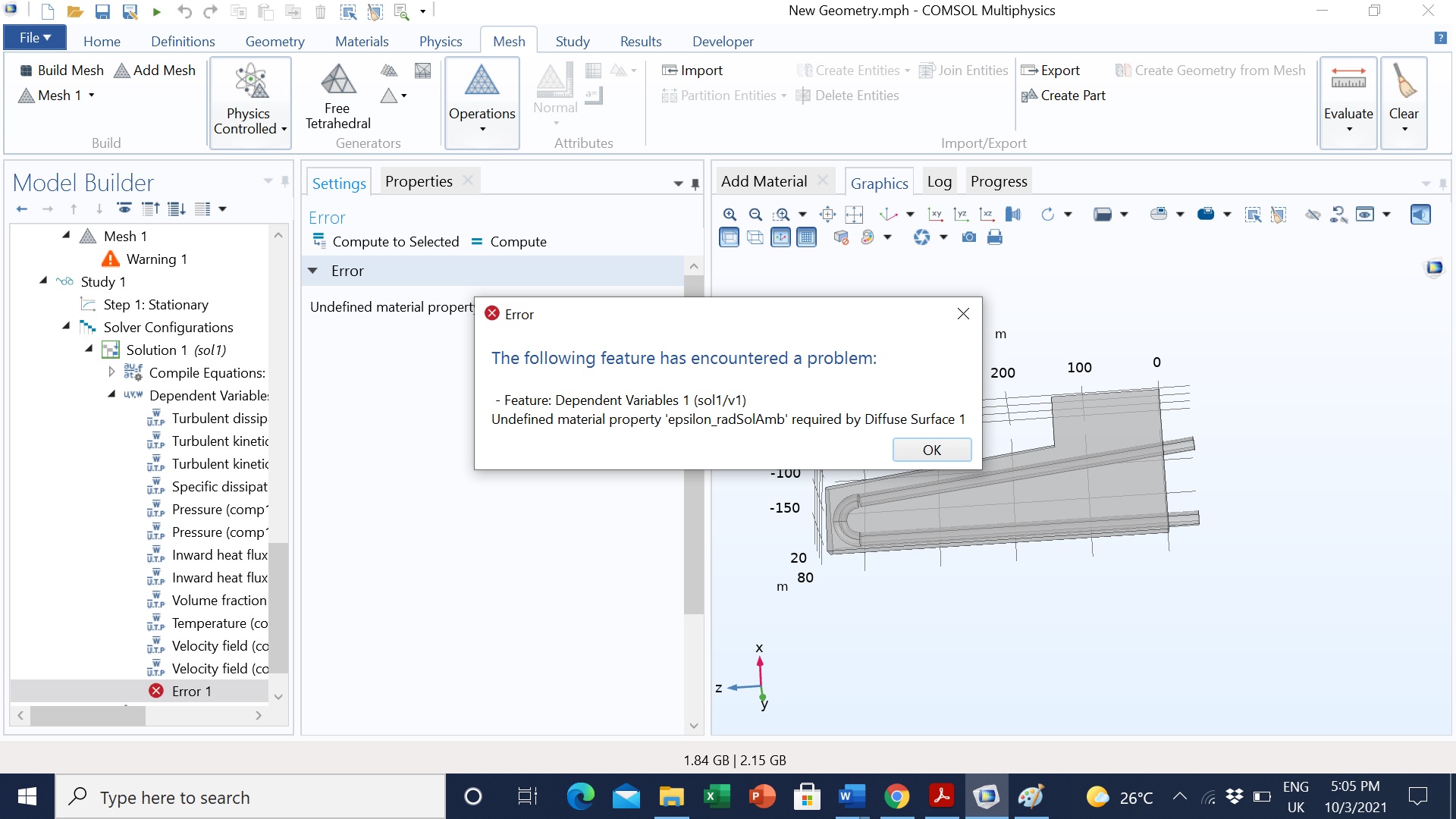

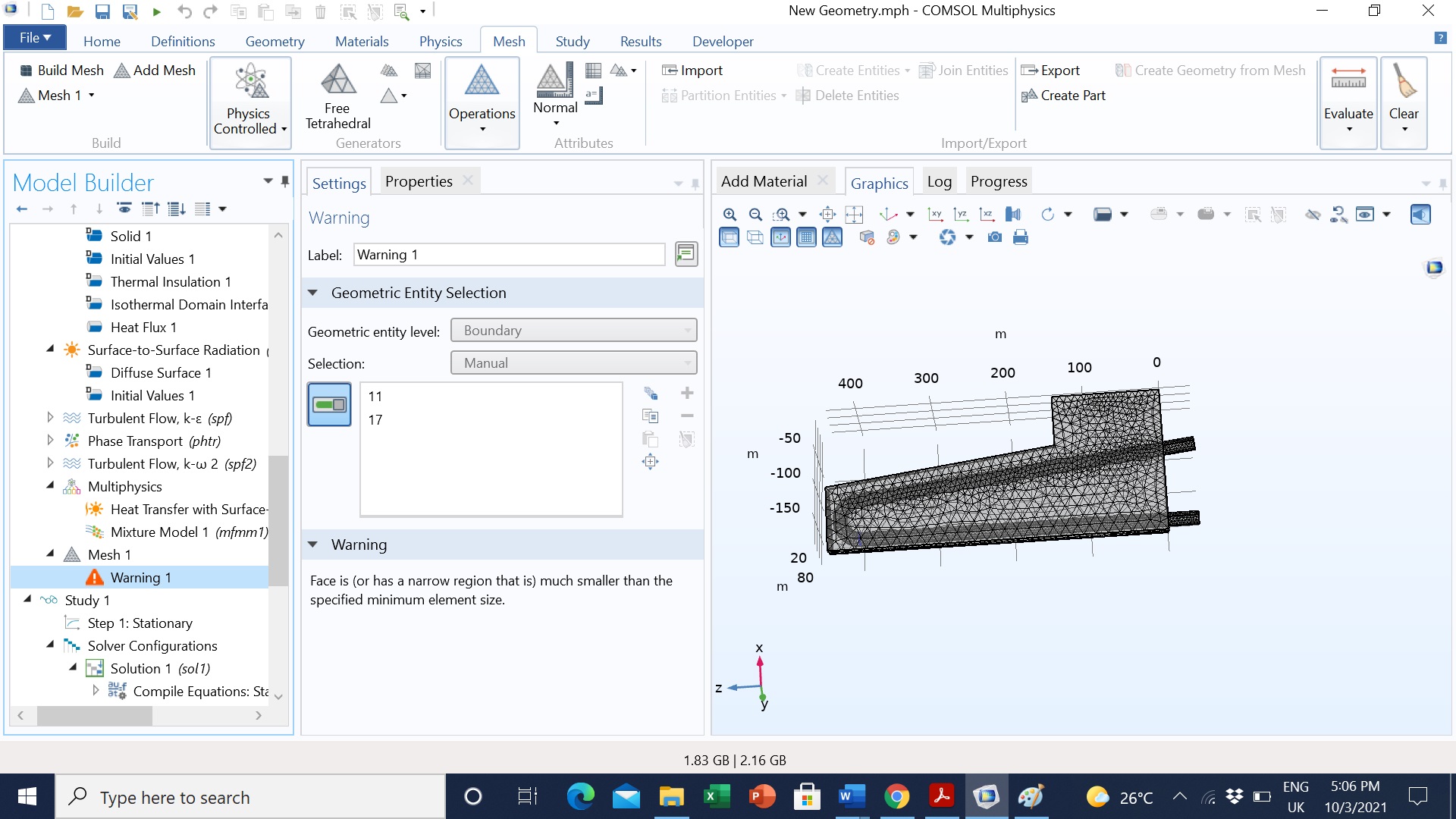

The below post is related to an [archived discussion](/forum/thread/35049/unable-to-create-mesh-error-free-tetrahedral-1 Hello everyone I'm doing my thesis about simulation of Solar concentrator dish and I build up the model and defined the materials, I presumes that everything is done correctly but still have an error when I build the mesh. can enyone help me please! please have a look on the error photos below !! Thanks in advance

It is very difficult to look at the reason for the mesh warning without the model. That being said, what you have received is a mesh warning, (NOT a mesh error), which may not affect the solution anyway.
The simulation error message is nothing to do with that mesh warning, it looks like you are missing the definition of a variable somewhere in your model.
It is very difficult to look at the reason for the mesh warning without the model. That being said, what you have received is a mesh warning, (NOT a mesh error), which may not affect the solution anyway. The simulation error message is nothing to do with that mesh warning, it looks like you are missing the definition of a variable somewhere in your model.
