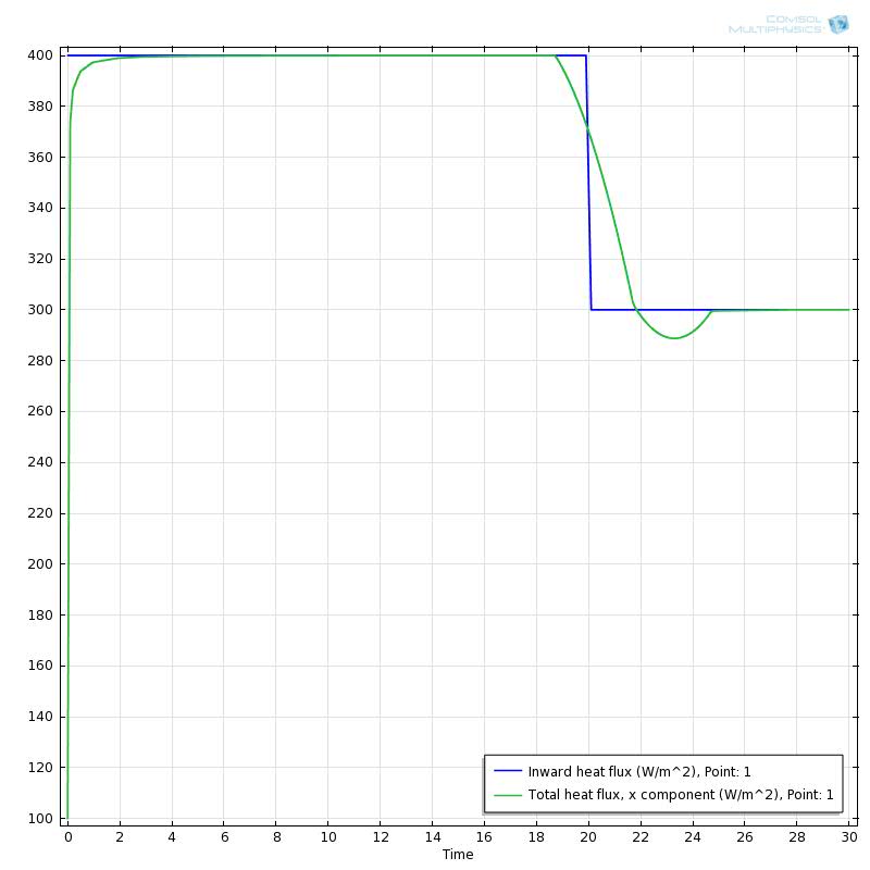

The problem I am having is the heat flux begins to decrease earlier than what was programmed. The attached file shows a plot of the inward heat flux (which is exactly what was programmed) and the total heat flux. I found that I could fix this by decreasing the maximum time step. But for more complex models I can't decrease the time stepping due to the high computation time.
I am not looking to change my current model. Instead I would just like to know how Comsol determines a time dependent solution and why a large time step results in this change occurring earlier than expected.

have you checked that your mesh is compatible with the gradients generated by a 0.1 sec abrupt temperature change ?, how many mesh elements are there across he heat front as it propagates ? Because you do not only have an earlier drop, but also an undershoot (numerical ?)
changin time stepping is one way, changing the mesh is another to cope with transient thermal effects
But again I am mainly just trying to understand what Comsol is actually doing. My guess is that instead of solving from a time of 0 sec to a time of 30 sec, Comsol is solving all time steps simultaneously. And therefore Comsol is trying to center the transition zone around 20 sec instead of starting the transition zone at 20 sec. But I don't know how Comsol obtains its solution, so I don't know if this explanation is correct.
-John

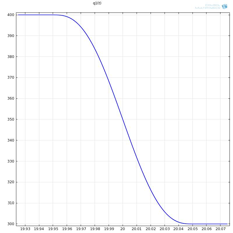

but if you are using the standard step() function it's value is 0.5 at the t=0 time, hence the transition starts at Dt/2 before t=0 and ends at Dt/2 after, where Dt is the transition time, try a plot of step1()

I do not have any explanations, would need to understand more about the model and the set-up, but heat fluxes are not always the most precise. Have you read through theknowledge base articles on heat flux calculations and tip&tricks ? Take a look, that might give you a clue
COMSOL could be taking big time steps close to 20 seconds. For example if COMSOL solves at t=18 and then uses a step size of 2.0 then the next solution time will be t=20. If you request the results at t=19 it will be an interpolated result. You can check that from the Log tab. If that is the case restrict the maximum time step the solver can take to a smaller value.

your are right, it depends also on the settings of the time stepper, automatic, intermediate or strict (and perhaps some new things in 4., I3 havent had time to get there yet ;)
