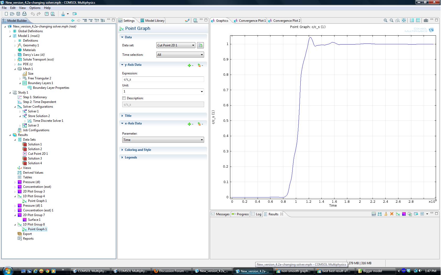

Thank you very much for your response. The good news is the results of the both versions are similar after changing some issue in mesh and discretization orders. By adding a boundary layer mesh to boundary number 6, and change the discretization order for solute transport from linear to quadratic, the results are much similar now.
But unfortunately, the new version does not show smooth graph. I have tried ''time discrete solver'' and changing Relative tolerance and absolute tolerance. But till do not get smooth graph (attached: screen shoot of this graph ). Can you please suggest something about this issue?
I have also attached the latest version of my model.

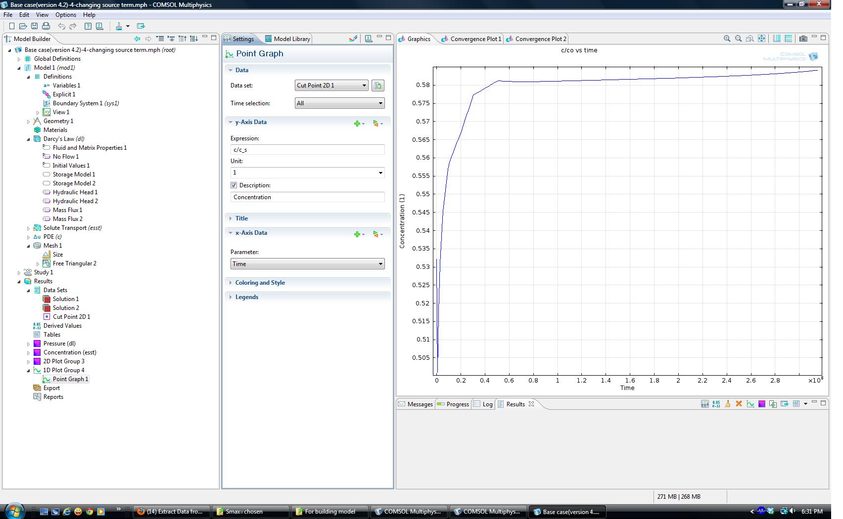

                                                    Hm, to my understanding the little jump at the top of the sigmoid is because of saturation - mostly relating to immobile fluid. Why it occurs in one version and not on the other, I have no clue.

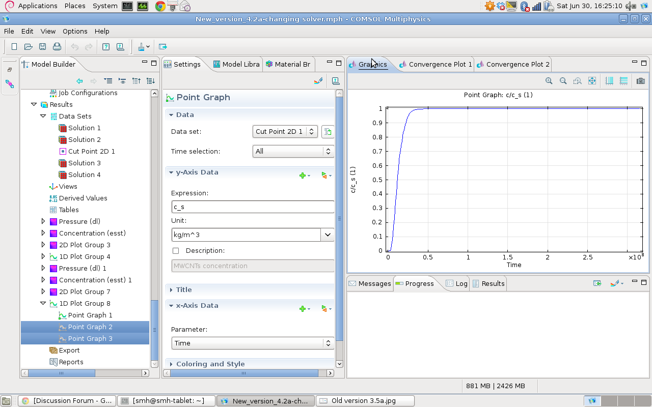

It would seem that the issue lies in solute transport. I used S01 in solute source 1 and S02 as solute source 2. I got the results found in the attachment - it gives a smooth curve, I leave it to you to determine the physical meaning.

Thank you very much for your suggestion. Yes, the graph is smooth now. And surly I will find the physical meaning behind it and let you know.

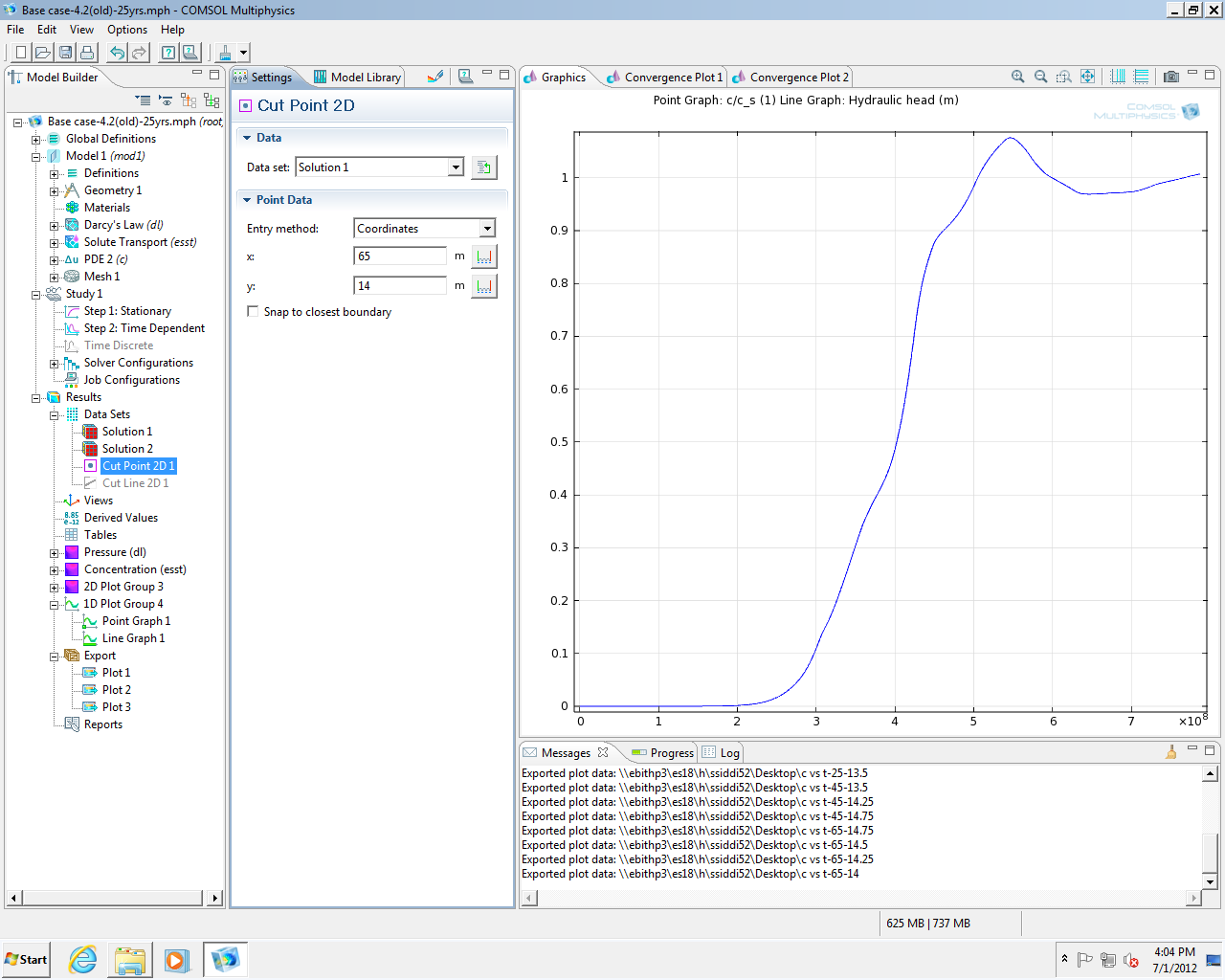

According to your suggestion, I have changed the S01 and S02 terms and got smooth curves for 10years with time step 10days. But when I run the simulations for 25 years with time step 10days, the graphs are not smooth. The model can generate smooth graphs at y=14.75m , but when I check the graphs below that y, do not get any smooth graphs (attached screenshot).
I have tried different versions to solve this issue (like-version 4.2a and version 4.2), but face same problem. I have also tried different solvers. Can you please suggest something about this issue?
The latest model has been also attached with this mail for your kind consideration.
