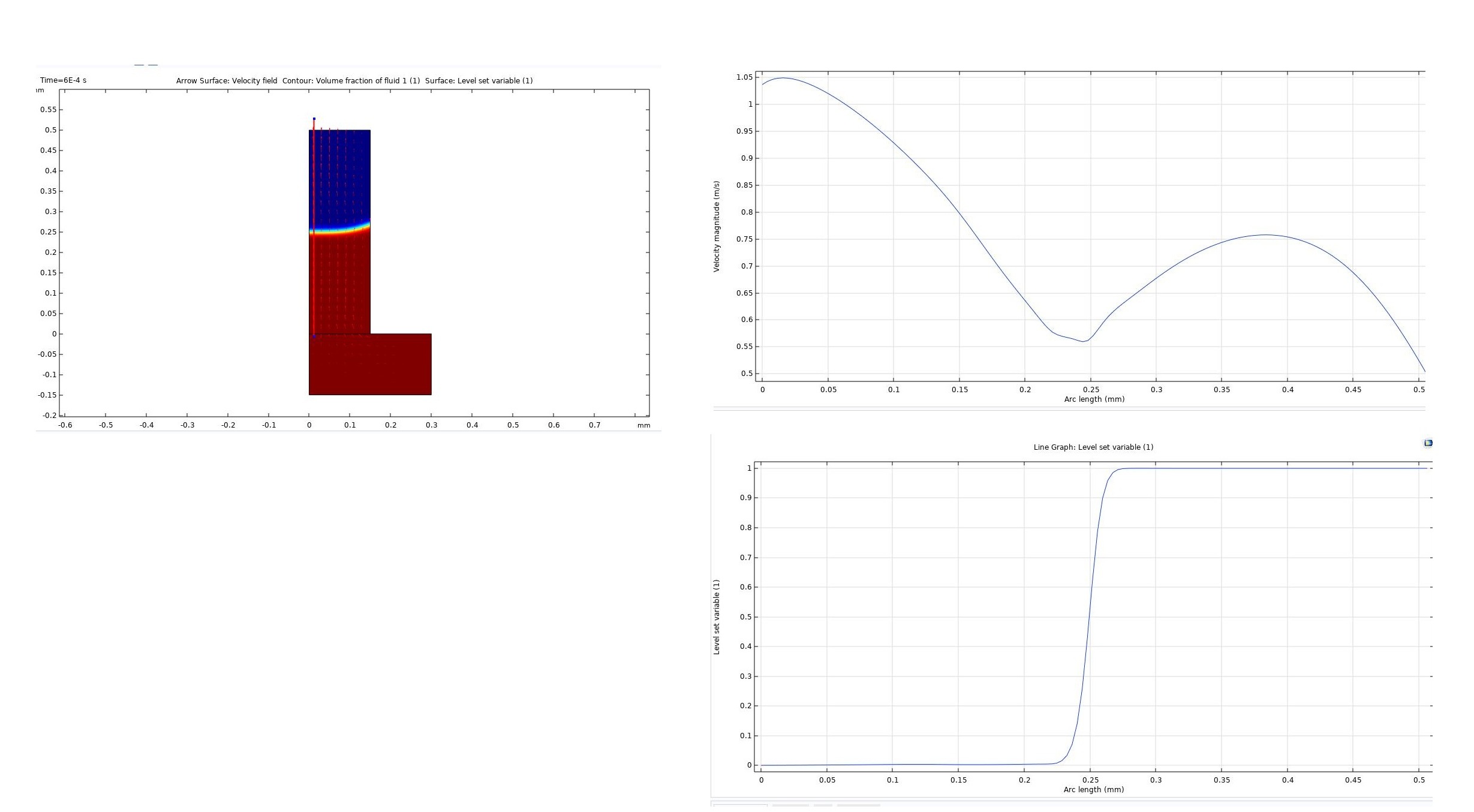

In two-phase flow simulation, the phase lost is an serious problem in level set method. we found that the velocity field across two-phase interface is mistake when using level set method or phase field method in COMSOL. the example show in COMSOL model library is also wrong. the following picture showed that the velocity is concave across the interface. it should be smooth. why ?

Regarding the capillary filling model, the reason for the variation of the velocity magnitude along the cut line is that the liquid enters the domain radially and is forced around a corner. You can see this in the Arrow Surface 1 plot in the Velocity plot group.

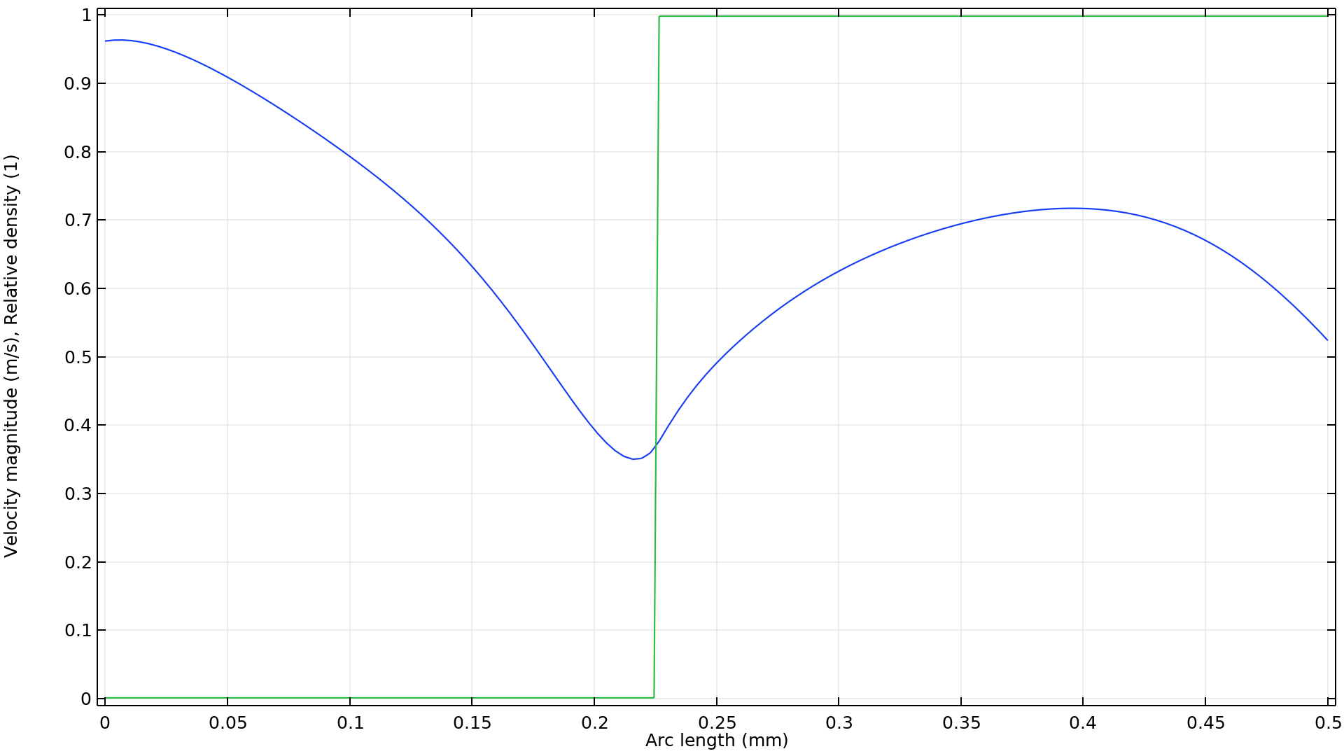

For reference, I have included the corresponding plot of the velocity magnitude along the cut line from a moving-mesh simulation. This is a sharp-interface method, which is more accurate, but you can clearly see the same shape. The magnitude is slightly less because of the no-slip boundary condition at the wall (in the level-set simulation, a Navier-slip condition is applied), but the variation and especially the "concaveness" is larger since the interface is now sharp.
So there is no mistake, there is nothing wrong with the tutorial. This is in a way the beauty with modeling. What you thought is a mistake reveals that even in this simple example, the results are not completely trivial to understand.
