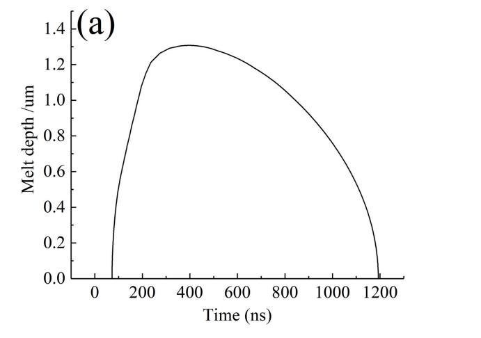

I have checked it out. Is  there  a mathematical expression to call out the melt depth in the result section?

You may try integrating a function which is 1 in the liquid and 0 in the solid. Let Tm be the melting point. Then the function is:
if(T<Tm,0,1)
and the liquid depth is:
intop1(if(T<Tm,0,1))
