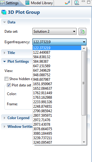

Perhaps it's a coincidence, but I get exactly 25 eigenfrequencies in the drop-down list that appears when selecting the eigenfrequency solution to plot. When there are more than 25 eigenfrequencies, a vertical scrollbar appears so that you can reach all computed eigenfrequencies even though you can only see a range of 25 at the time. This might be a reason why you think there is a limit of 25 eigenfrequencies.

Thank you for your reply. I was looking for the vertical scroll bar, but I can't see one. Could you send a screen capture?

In the attached screen capture, the vertical scrollbar is on the right in the list of eigenfrequencies.
Magnus Ringh, COMSOL
Thanks. Of course I saw the vertical scroll bar and the 25 eigen modes were counted after scrolling down all the way. For some reason I read the word 'vertical' in your reply and though about 'horizontal'. That's why I asked for a screen capture.
