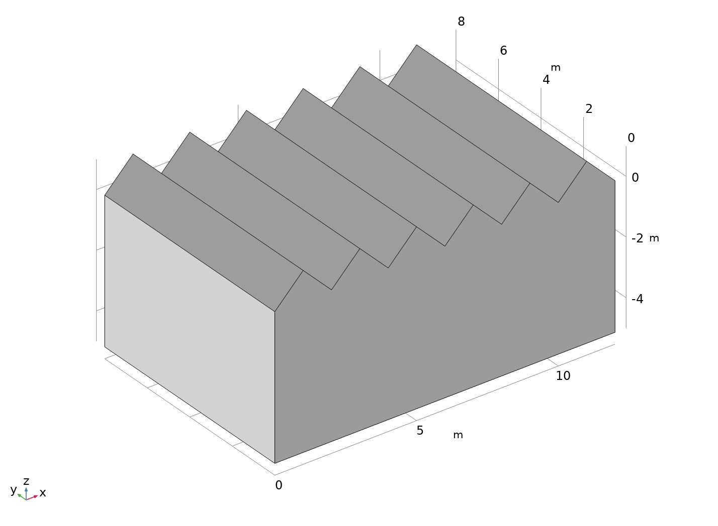

I am not able to draw the triangular spikes (more accurate image linked). I dont know what geometry to use. I think a triangular wave using parametric curve will get the job done but I couldn't find a triangular wave equation that works in parametric curve.

- Create a workplane.
- Draw your 2D structure, using the polygon tool.
- Extrude your structure into 3D.
I've attached an example. In the workplane, I used the polygon tool, the array tool, and the union operation.
1. Create a workplane.
2. Draw your 2D structure, using the polygon tool.
3. Extrude your structure into 3D.
I've attached an example. In the workplane, I used the *polygon* tool, the *array* tool, and the *union* operation.
