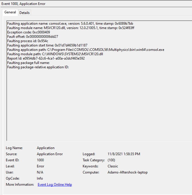

Below is the error information form the Windows Event Viewer:
Faulting application name: comsol.exe, version: 5.6.0.401, time stamp: 0x6089b7bb Faulting module name: MSVCR120.dll, version: 12.0.40649.5, time stamp: 0x56bc00d3 Exception code: 0xc0000409 Fault offset: 0x000000000006dd27 Faulting process id: 0x2e4c Faulting application start time: 0x01d7d1244e5820ad Faulting application path: C:\Program Files\COMSOL\COMSOL56\Multiphysics_auth\bin\win64\comsol.exe Faulting module path: C:\Windows\SYSTEM32\MSVCR120.dll Report Id: e77aad8d-4910-4bc4-9a67-1cfb0c616611 Faulting package full name: Faulting package-relative application ID:
The issue happens because there is already a MSVCR120.dll in my C:\Windows\SYSTEM32 which has a version different from the MSVCR120.dll used by COMSOL5.6. This MSVCR120.dll seems has been actively used by my NVidia software so it cannot be modified.
I have tried run ext/vcredist_x64.exe, however the version of MSVCR120.dll would not be able to change.
Really wish anyone who may experience the same issue to help.

An update to the problem. I have tried the installation on two different laptops with NVidia GPU. The same issue has happened on two different computers. On both computers, the MSVCR120.dll of different version has been used by the NVidia GPU software. I have tried all the solutions suggested by the support team, none of them works.
I really hope this issue can be raised to attention because this is really a very serious issue. One would not buy the license of COMSOL if this software cannot be installed on any of his computers. I do hope to get an updated response if this issue can really be effectively solved.

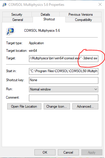

Have you tried starting COMSOL 5.6 using software rendering? You can set it up before launching COMSOL in the preference file in the .comsol directory under your user directory as
graphics.rendering.3drend=sw
(the default is ogl for OpenGL rendering)
Magnus
Hi, Have you tried starting COMSOL 5.6 using software rendering? You can set it up before launching COMSOL in the preference file in the `.comsol` directory under your user directory as `graphics.rendering.3drend=sw` (the default is `ogl` for OpenGL rendering) Best regards, Magnus

Hi Magnus,
Thank you so much for the suggestion. I have tried with adding " -3drend sw" into the target line in shortcut.
The same issue still happens and nothing changed. I guess it may not be the rendering issue.
Thank you very much for the suggestion.
Magnus
Hi Magnus, Thank you so much for the suggestion. I have tried with adding " -3drend sw" into the target line in shortcut. The same issue still happens and nothing changed. I guess it may not be the rendering issue. Thank you very much for the suggestion. Regards Roy >Hi, > >Have you tried starting COMSOL 5.6 using software rendering? You can set it up before launching COMSOL in the preference file in the `.comsol` directory under your user directory as > >`graphics.rendering.3drend=sw` > >(the default is `ogl` for OpenGL rendering) > >Best regards, > >Magnus

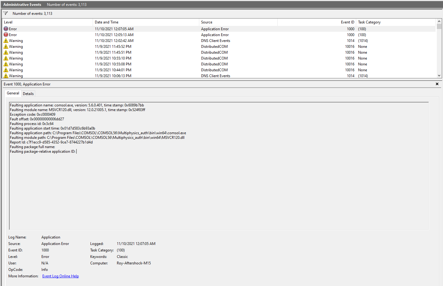

Update
I have copied the file C:\Program Files\COMSOL\COMSOL56\Multiphysics\java\win64\jre\bin\msvcr120.dll to the directory C:\Program Files\COMSOL\COMSOL56\Multiphysics\bin\win64\ .
The same issue but a different msg has been shown.
Update I have copied the file C:\Program Files\COMSOL\COMSOL56\Multiphysics\java\win64\jre\bin\msvcr120.dll to the directory C:\Program Files\COMSOL\COMSOL56\Multiphysics\bin\win64\ . The same issue but a different msg has been shown.
