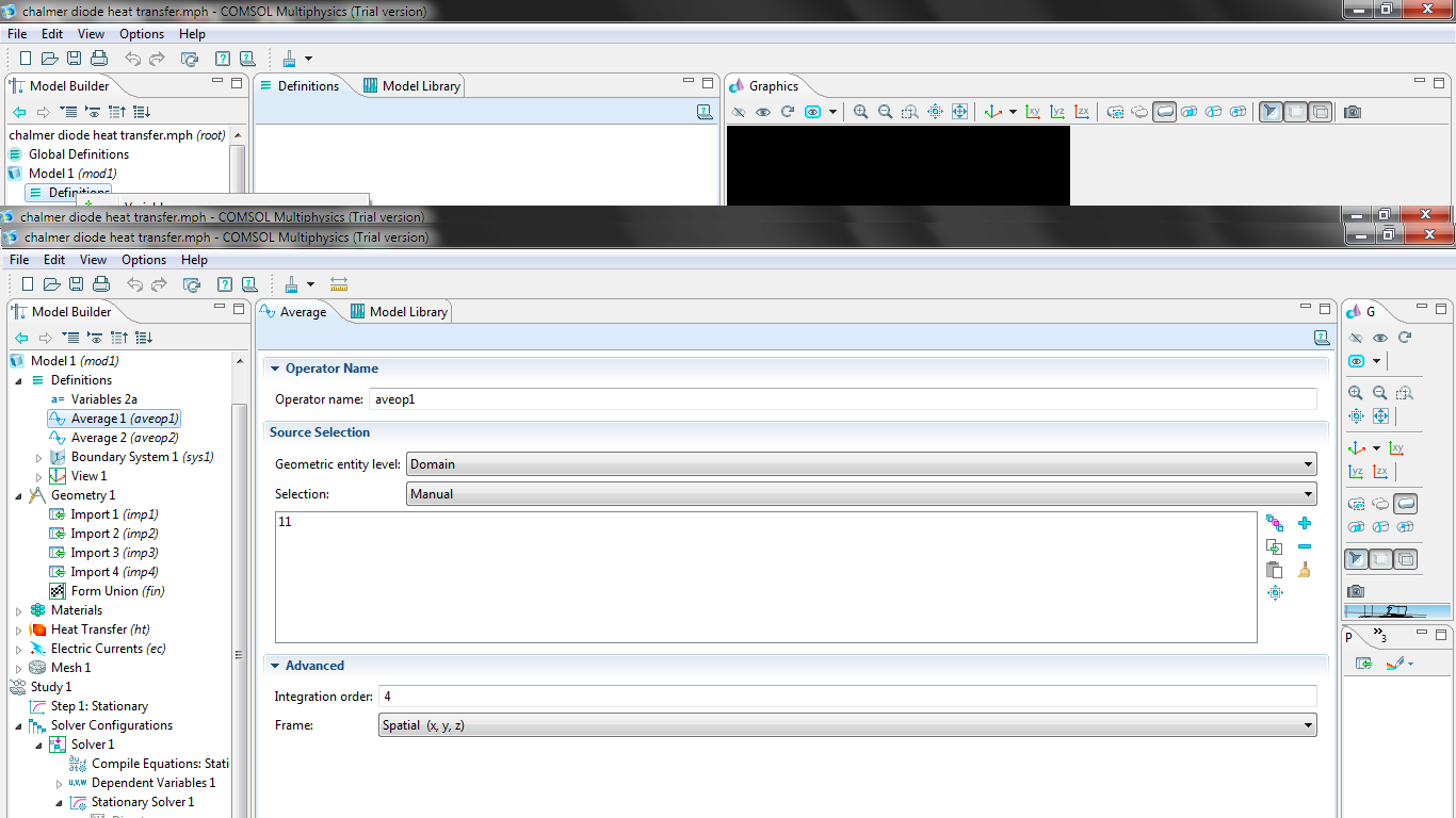

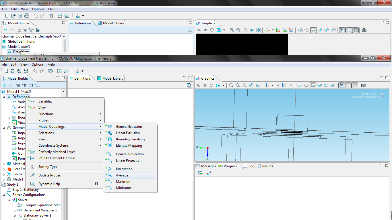

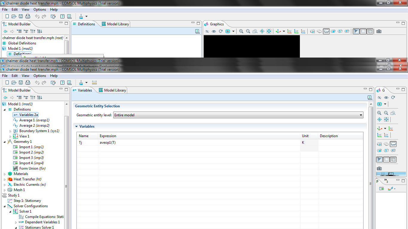

sorry for the late reply Oscar. I was away. I took Ivar's suggestion. I defined a paramemter MyT and then model coupling and average. select the domain. The average variable name is aveop1. Then use a variable with the name like T_m as aveop1(T). hope it works for you.
BR,
Arif
sorry for the late reply Oscar. I was away. I took Ivar's suggestion. I defined a paramemter MyT and then model coupling and average. select the domain. The average variable name is aveop1. Then use a variable with the name like T_m as aveop1(T). hope it works for you. BR, Arif

so, for example, if I want the average of the concentration in a domain, I go to Detinitions-Model Couplings-Average, I choose the domain and then in the operator name, I write:
aveop1(c), but then it says
"Invalid property value
-Property: opname "Operator name" is a string. Must be a valid variable name"
Any idea what is happening?
Hi, so, for example, if I want the average of the concentration in a domain, I go to Detinitions-Model Couplings-Average, I choose the domain and then in the operator name, I write: aveop1(c), but then it says "Invalid property value -Property: opname "Operator name" is a string. Must be a valid variable name" Any idea what is happening?

I think I got it, first I just simply define the average operation, I create aveop1 selecting my domain.
Then I create a variable for that specific domain, for example:
c aveop1(c1)
and now I can have all my properties in function of the average concentration "c" , like
rho (density)=(1+0.00934*c)*(A+B+C)
Am I right??
Hi, Yeah, c is the dependant variable. I am using the transport of diluted species of the Chemical Reaction library. I think I got it, first I just simply define the average operation, I create aveop1 selecting my domain. Then I create a variable for that specific domain, for example: c aveop1(c1) and now I can have all my properties in function of the average concentration "c" , like rho (density)=(1+0.00934*c)*(A+B+C) Am I right??
