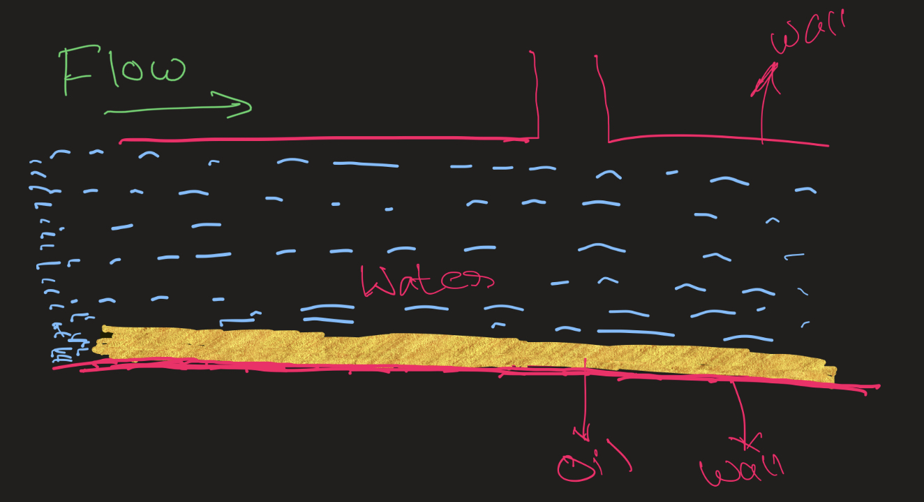

I would like to visualize an interface between the immiscible fluids in a straight channel where the bottom wall is patched (10 micrometer thick) with an oil and then water is passed over the oil surface (covering the entire inlet as such the oil patched at the bottom flows along with the water forming an interface) as shown in the attached figure.

To patch the oil on to the bottom wall, define an inlet in the level set node and set the condition to either Fluid 1 (phi=0) or Fluid 2 (phi=1), whichever the oil is assigned to.

you should draw geometry with region that used to set oil region, and then set oil with initial level set parameter. The initial set is now same as FLUENT, which uses Patch.
