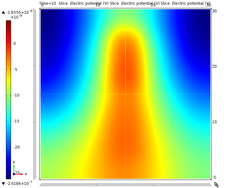

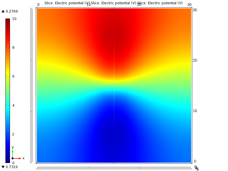

I asked u in other thread about ac field in time dependent . i used ac/dc in electrostatic nd applied 10*sin(2*pi*f*t).
in terminal settings. t varied between 1-10 sec. but i dont know what i did wrong . potential came in negative and field distorted. in DC it looks fine.may be i am doing something basic wrong. I m new to comsol so plz look into this.
your DC looks proably reasonable, but the AC is basically "0", no ?
if you use a time series, for 10 seconds or more, what kind of frequency do you have ? if its in the MHz domain, you need to sample (time step) in the sub microsecond level, henceit will calculate for ages perhaps 10E6 times ?
Are you sure its not better to use a harmonic solver (frequency domain) ? and solve for the amplitude, than use a transient solver in time series ?
If you use a time solver, be sure you use a strict or intermediate time stepping, with a time sequence short enough to resolve each frequency oscillation

I time stepping solver is good for transients or for some special cases of regular AC oscillations, but it requires quite some time to solve, as you need to go through each time steps, and with small steps sufficient to solve each wave oscillation.
The other way is to say you have a steady sate AC oscillation, you performa Laplace development (harmonic development) of your equations and you define the frequency, or rather omega = 2*pi*freq.
This is what happens when you choose a harmonic solver case (check the equations that COMSOL proposes, you will se the "t" change to "omega" ) in this mode you define amplitudes for the BCs and you do not give any "sin(2*pi*f*t)" equation at all. COMSOL then requests you to define the frequency, or a sweep over a series of frequency, in the harmonic solver node under "frequency" entry (use 100[Hz] or range(10,10,100) or whatever you want
A harmonic solver case is easier to solve and reuires less RAM, but assumes a steady state AC oscillation apart some special new special solver cases as the harmonic - transient case, see the doc, its worth to read it carefully
thank you very much for this explanation . one more question sir how would i know or how could i calculate the accurate time step for proper result. i used 0 to 1e-9 with step 1e-10. it gave me result similar to DC.
