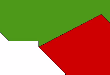

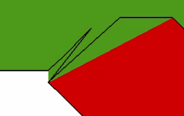

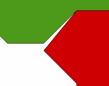

I have a complex 2D geometry which undergoes a number of merge vertices operations with aims to refine the mesh, however it seems to attempt to mesh a strange hybrid where boundaries and points have a mix of aspects from the geometry built up to the 'fin' node and the fully built virtual geometry.
Domains fit that of the virtual geometry unless they get meshed, at which point it will stretch to fit its new boundary, often causing it to overlap into other domains which then cannot be meshed.
Attatched are 3 images of a single example, which consistently occurs accross other examples. These images are of the same section of the geometry built up to the 'fin' node, refined with virtual operations and what is displayed when checking a built mesh. The three domains shown did not get meshed due to the effects described above, though in a case where the white one would, it would fill in that sliver, overlapping the green segment, preventing the green from being meshed.
Selecting geometric entities works completely as expected in the geometry built up to any point, this is also true when I create an unbuilt mesh module, it's only when the mesh is built and the module is selected that the boundaries shift. This issue persists with physics controlled and user controlled meshes.
Is this a known issue? Is there anything I can do?

An update, I managed to completely solve this issue by simply adding an edge meshing step before any domain meshing step
