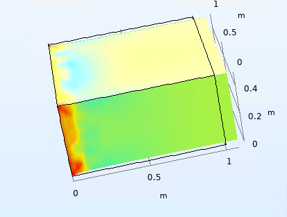

I am fairly new to COMSOL and was playing around. I simulated a block of a rubbery material. When I fixed one boundary and assigned a displacement to the other, the limit at which the it stopped "stretching" was below the assigned displacement?
I experimented from adding forces etc, but the displacement is the same?

Hello Ewe,
Check if you may have committed this common misinterpretation.
Hello Ewe, Check if you may have committed [this common misinterpretation](https://www.comsol.com/forum/thread/231422/how-to-prescribe-displacement-amplitude?last=2019-04-09T20:55:03Z). Best, Jeff
