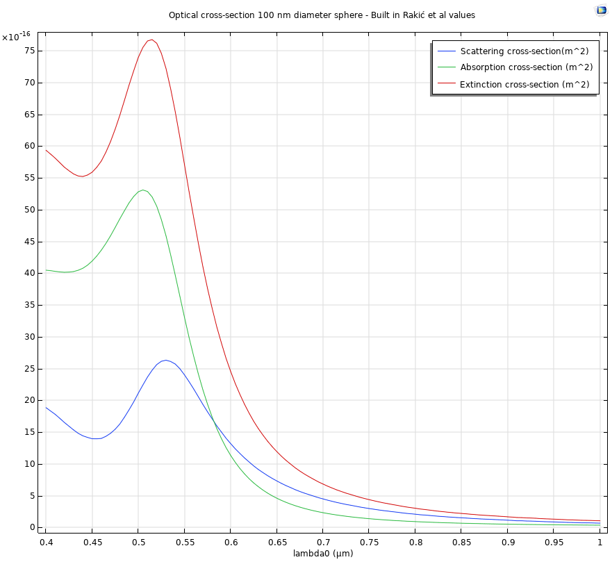

I have done two different dispersion models of the gold sphere. The first is using refractive index values from the built-in "Rakić et al lorentz-drude model" (application library model uses Brendel-Bormann).

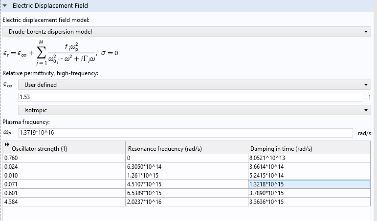

The second was using a seperate electric wave equation for the sphere domain with the lorentz-drude values from the Rakić et al(1998) paper entered in the comsol model (converted to proper units).
The first result is in accordance with Mie-theory while the one using comsol's Drude-Lorentz dispersion model has a unexpected redshift. (see figures)
Can anyone help me shed some light at what might've caused this?
