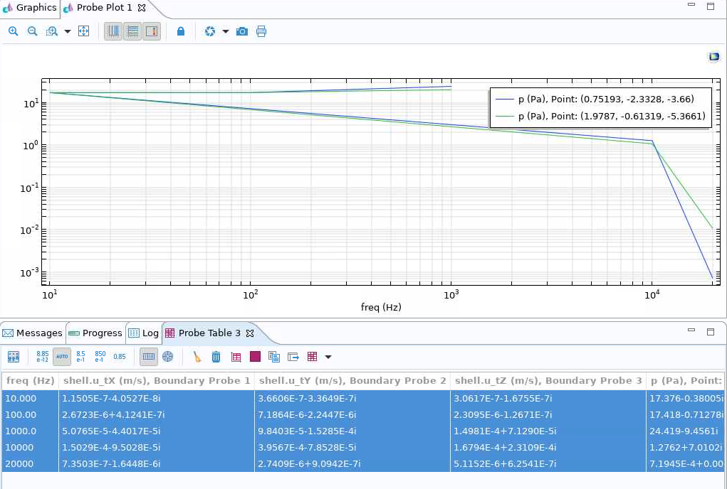

Hi, I am new to COMSOL and I am trying to plot a table of probes data. However, the plot does not follow the sequence of the data and gives me wired plot (See the attachement). How can I fix it?

You are plotting complex-valued data. That means that the real part is used. If the real part is negative, it cannot be shown on a logarithmic scale. That can be a reason for strange plots.
Maybe using abs(expr) is better?
