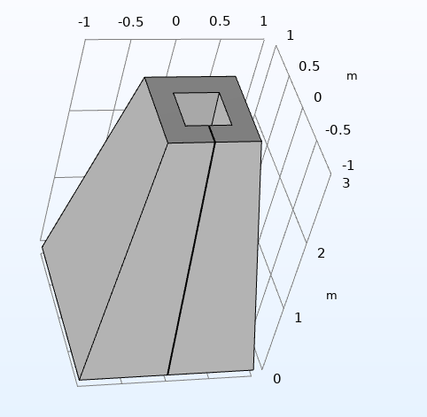

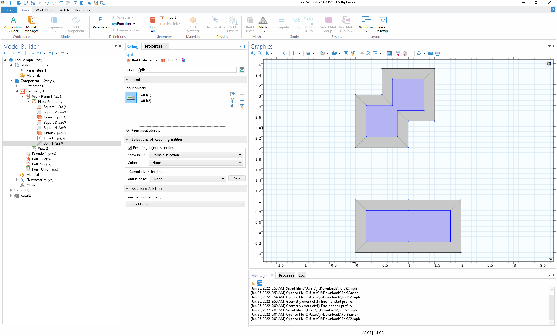

Offsetting cannot have multiple connected domains (see 1st picture) When selecting all shapes in work plane, then we have disconnected shrunk shapes (see 2nd picture).
Then if we'd extrude and loft, we would get an "internal" slope between the 2 squares, wouldn't we?

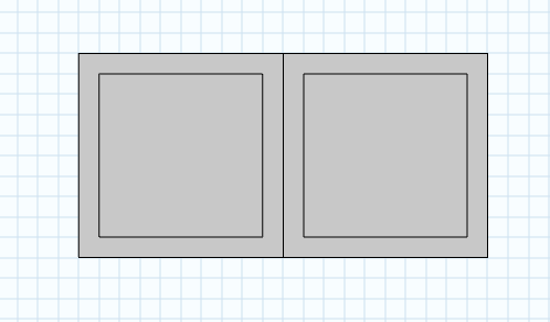

Hello Eric,
In that case (overlapping or contiguous squares/rectangles), you can take the union of the two squares/rectangles with the "keep interior boundaries" checkbox turned off (this will remove undesired internal edges) before taking the offset.
See attached screenshots and mph file (for when you can open it). One of the screenshots shows a Split operation that I did not mention yesterday.
Hello Eric, In that case (overlapping or contiguous squares/rectangles), you can take the union of the two squares/rectangles with the "keep interior boundaries" checkbox turned off (this will remove undesired internal edges) before taking the offset. See attached screenshots and mph file (for when you can open it). One of the screenshots shows a Split operation that I did not mention yesterday. Best, Jeff

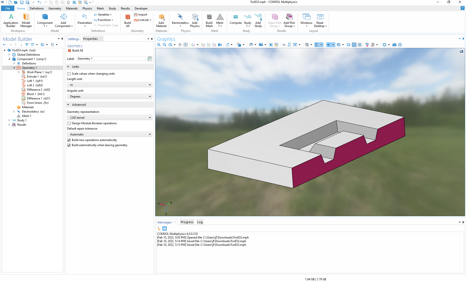

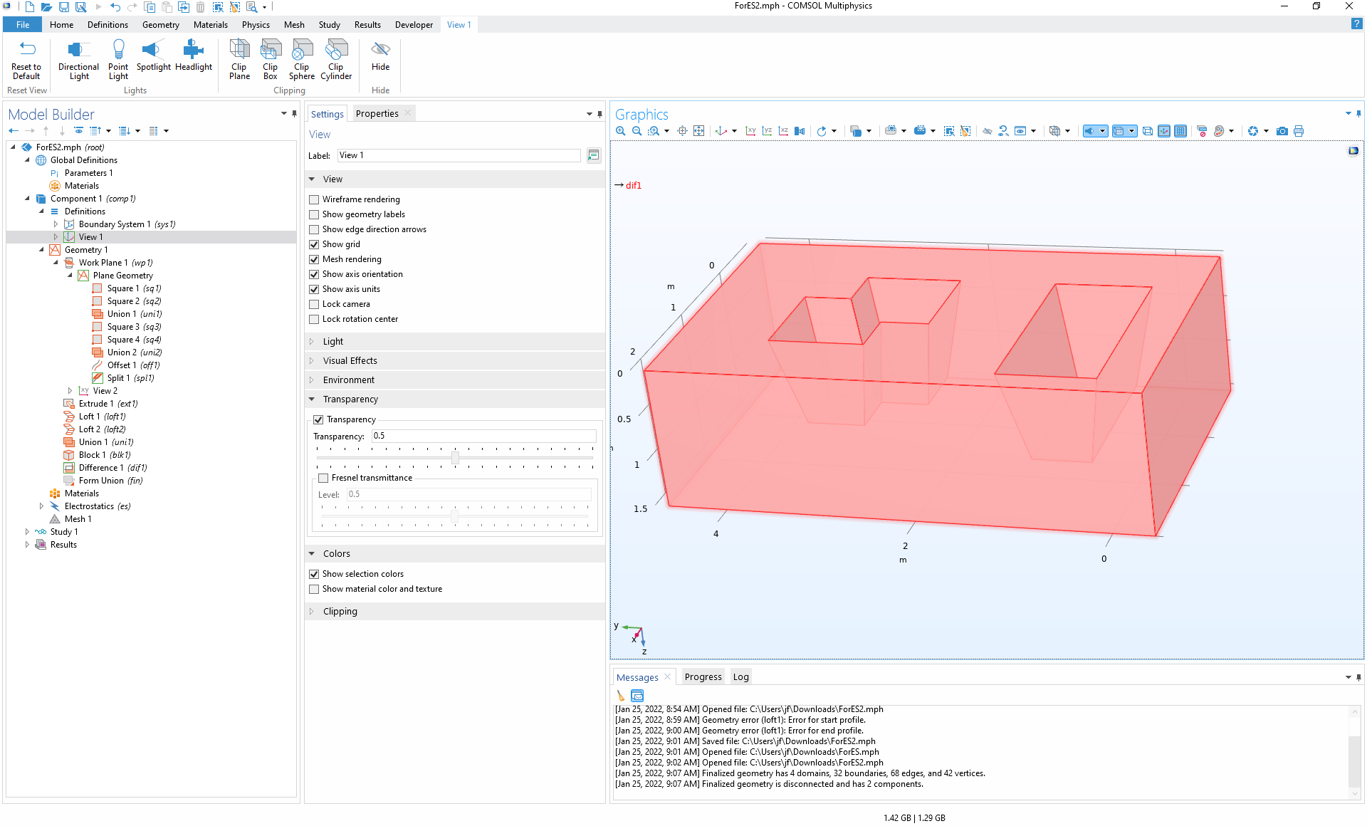

Hi Eric,
Lofting does work one loop at a time, so for the case you describe in your latest message you can use two loft operations, one for the inner loop and one for the outer loop, as shown in the attached files.
Hi Eric, Lofting does work one loop at a time, so for the case you describe in your latest message you can use two loft operations, one for the inner loop and one for the outer loop, as shown in the attached files. Best, Jeff
