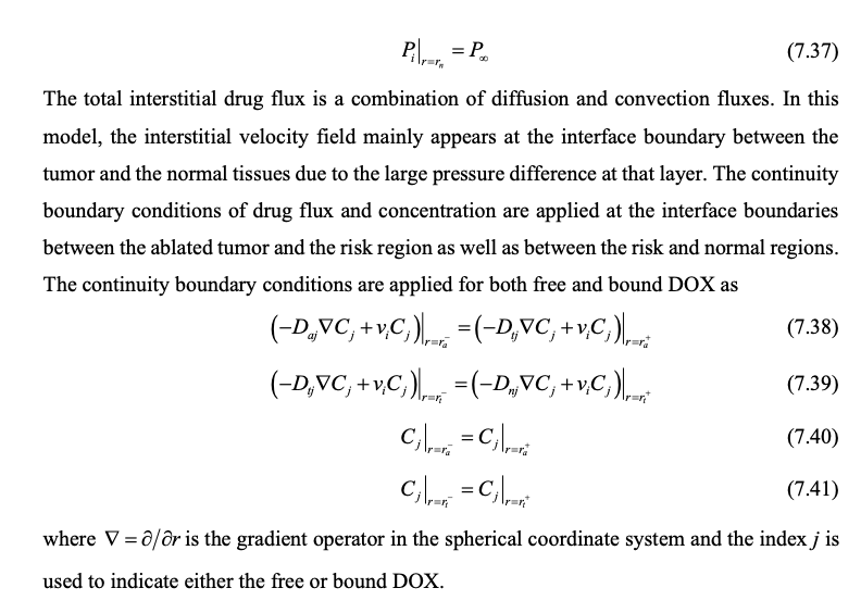

I am working on the drug implant system, first I used darcy law to find pressure and velocity but while applying darcy law I have to set boundary conditions eq: 7.32 and 7.33 as attached in the picture. And secondly for finding the concentration I used Transport of dilute species. But for all these I have to set continuity boundary conditions at the interfaces. Can you please guide me how can I apply such type of boundary conditions in COMSOL 5.3a version?
