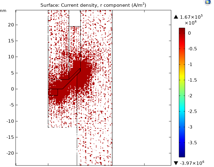

why the result of surface plot in COMSOL is not in filled unified color and more is like pixel color? how can I have filled?

please check the data range section in the plot settings. if you have set the data range to manual, then only a part of the data will be plotted and rest will be blank.
not sure of any other solution to this problem.
please check the data range section in the plot settings. if you have set the data range to manual, then only a part of the data will be plotted and rest will be blank. not sure of any other solution to this problem.

What graphics card and driver do you use? I think that I remember seeing what you see in problem.png for a buggy graphics driver. I recommend you to update the graphics driver to the latest version.
