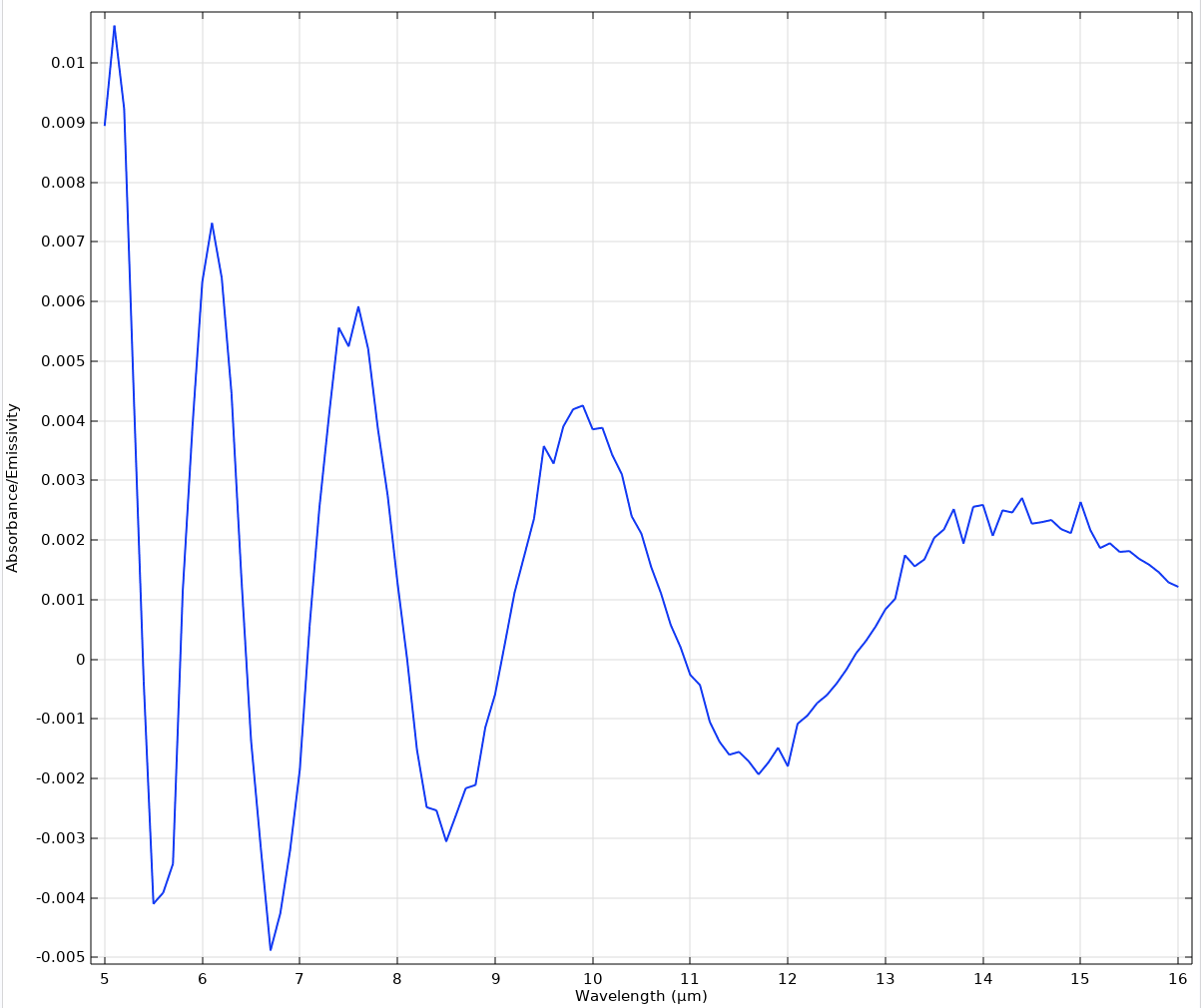

Help with generating emissivity plots for thin metal foils under the infrared spectrum
When trying to generate emissivity plots of thin metal films (e.g., silver), I get oscillations with peaks below 0 emissivity (as shown in the attached image). From what I have seen in the literature, there should not be any oscillations and instead have an almost linear curve at around 0.004 emissivity.

Are you perhaps plotting the real part of something instaed of its magnitude?
