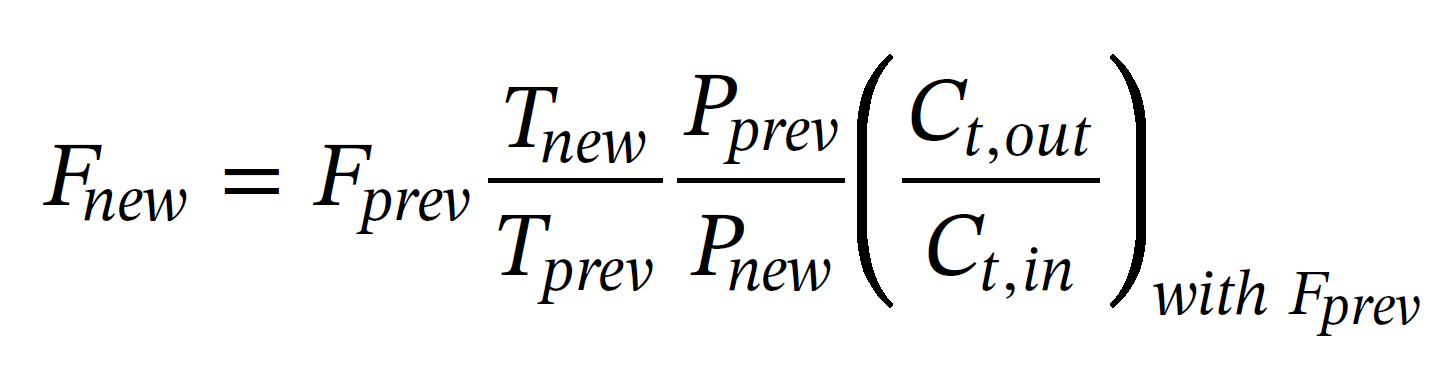

I was able to solve the issue I had, but I am now wondering about something else. I am still solving the mass and energy balance equations, but I also want to update the velocity after each time step. Do you know how I could most easily implement an equation that does this timestep update of the velocity? Would it be creating a global function, or perhaps solving it as a global ODE/DAE from the math interface? I have read about the operator p(expr, i). As I understood it, this gives the value of expr in the timestep i before the current timestep? I am attaching a photo of the equation I want to implement. F is the variable I want to update, and Ct and Tf are dependent variables from the mass and energy balance equations respectively. The variable will then be used in both the mass and energy balance equation as the convection coefficient beta.
I tried to implement it as a global ODE/DAE, but COMSOL did not recognize the dependent variables from the already implemented mass and energy balance equations.
Best, Nora
Hi, Thank you for your help! I was able to solve the issue I had, but I am now wondering about something else. I am still solving the mass and energy balance equations, but I also want to update the velocity after each time step. Do you know how I could most easily implement an equation that does this timestep update of the velocity? Would it be creating a global function, or perhaps solving it as a global ODE/DAE from the math interface? I have read about the operator p(expr, i). As I understood it, this gives the value of expr in the timestep i before the current timestep? I am attaching a photo of the equation I want to implement. F is the variable I want to update, and Ct and Tf are dependent variables from the mass and energy balance equations respectively. The variable will then be used in both the mass and energy balance equation as the convection coefficient beta. I tried to implement it as a global ODE/DAE, but COMSOL did not recognize the dependent variables from the already implemented mass and energy balance equations. Best, Nora

Hello Nora,
Your image, it seems, reflects some form of discrete timestepping (with "new" and "prev" referencing two different times). Usually in COMSOL the user should implement equations in their underlying time-as-a-continuum form, and leave the time stepping to the software.
Hello Nora, Your image, it seems, reflects some form of discrete timestepping (with "new" and "prev" referencing two different times). Usually in COMSOL the user should implement equations in their underlying time-as-a-continuum form, and leave the time stepping to the software. Best, Jeff

Hello again,
Thank you for your quick reply!
Yes the equation is in this form to use less computing resources asociated with updating the value, and is more used to couple the energy and mass balance equations. Is it possible to implement it this way in COMSOL?
If I then instead implement the equation for the flow in the time-as-a-continuum form, what interface can I use in order to use the dependent variables of the other equations as arguments in the flow equation?
Best, Nora
Hello again, Thank you for your quick reply! Yes the equation is in this form to use less computing resources asociated with updating the value, and is more used to couple the energy and mass balance equations. Is it possible to implement it this way in COMSOL? If I then instead implement the equation for the flow in the time-as-a-continuum form, what interface can I use in order to use the dependent variables of the other equations as arguments in the flow equation? Best, Nora

For various reasons, I wouldn't presume that the time-discrete approach actually will use less computing resources if you take control of the timestepping, nor that it would be more likely to converge to the correct solution.
Which interface to use depends on the nature of the equation you need to solve. Different interfaces are available for equations that are distributed spatially vs global, and for ODEs vs PDEs. You can obviously use the most general interfaces (those for spatially distributed PDEs) to handle the simplest case (global ODE), but you'd be wasting resources by storing duplicate data, so you usually use the interface that's "just right" for your situation. It's not clear to me from your image what case you're in. I'll try and guess.
My first interpretation of your earlier comment that "I tried to implement it as a global ODE/DAE, but COMSOL did not recognize the dependent variables" is that your underlying equation is a global one (ie. there is a single value of F that needs to be computed for the entire model at each time; F does not vary in space), but that you got an error because you tried to include in it terms that vary spatially. Either your equation is distributed (and can call variables that vary spatially) or it's not and it can't (at least not directly. This takes me back to my initial comment that coupling operators may be part of the solution (because they can be used to reduce the spatial dimensionality of variables by computing integrals, averages, etc, and can make data available elsewhere in the model)). If my guess is correct, then see Reference Manual, version 6.0, page 1233 and following.
A second possible interpretation of your earlier comment is that despite the fact that your underlying equation is distributed (F should vary over space and depend on other quantities that vary in space) you tried to enter it through an interface meant for for solving global equations. If that second interpretation is correct, then see Reference Manual, version 6.0, page 1154 and following.
PS: I hope this is clear enough. COMSOL is very flexible and in a 3D model allows you to set up equations defined on 0D entities, 1D entities (which don't have to be straight segments), 2D entities (which don't have to be flat surfaces, as illustrated by this example ) and 3D entities. I glossed over the intermediary dimensions (1D and 2D) above, but they may be of significance in your model since you are working with adsorption.
